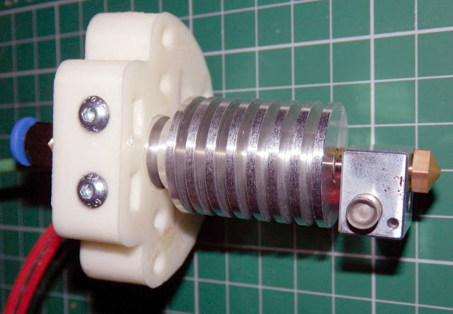

I'll add my week of testing to this thread -
I'm basically running it in exactly the same way as a J-head MKV - It can deal with a little less extruder reversal for PLA and ABS - I'm still tuning it for Nylon.
I have ran it as 15mm/sec to 80mm/sec with PLA, and with 0.5mm to 2.5mm retraction no issues at all.
I'm using exactly the same Temperature settings as the J-head, but it does seem to give sharp and crisp results with about +5 Degrees C more heat.
For me it performs really well for PLA and ABS - I'll be trying PC later this week.
But I have tried all week, and have not yet found a goon combination of settings for Nylon 618 or 645 - It's not performing like a J-head for Nylon - Anyone got any tips? or is anyone printing well with Nylon - The prints below are straight off the printer in PLA - I can get similar results to this in Nylon using a J-head, but not quite yet with the E3D.
I'm also going to say this hot-end is giving the sharpest prints and definition I have ever seen my worn out MendelMax Black print - Ever.

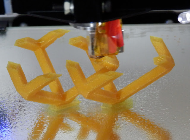

25% line infill - Bi Cube model 100% size
0.25mm Layers
65mm/sec infill speed
60mm/sec perimeter
2.5mm extruder retraction - Purposely using a long retraction on this model - normally 1.5mm is fine.
15 seconds minimum layer time - (needs to be a bit longer really - some curling)
Using the E3D Nozzle - 0.4mm / Stainless Steel
Gold PLA 1.75mm - 190 Degrees C
Small fan cooling the print - single object printed.
Two perimeters.
All images straight off the printer, not touched at all - (as they are for the competition going on Here)
Heated (64 Deg C) Mirror-Glass bed with Hairspray layer
Brim to aid sticking to Heated Bed.
Some very fine hairs and curling up on the side that was not cooled - only using one small fan - really must print and mount a nozzle ducted fan guide for PLA printing at some point soon. - Really liking this Ultimaker one from Owen - Anyone using anything similar on a RepRap?

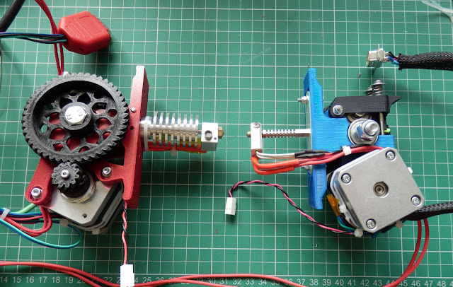

I'm going to be doing a full review for Issue 3 of the RepRap Magazine, so watch out for that (after we all get Issue 2 finished that is!)
But since you asked and I did post that photo...
Prusa Nozzle -
Josef is still tweaking the Prusa Nozzle so it's not totally finished yet, but it's the Hot end with the fastest print capability at the moment, in fact it likes to go fast and hot, not quite as easy to use it going very slowly at the moment, but Josef's modifications will make this aspect better.
E3D -
It's the most accurate and controlled nozzle I have ever used (so far) - for PLA and ABS - I'm still working out how best to use it with Nylon, but It's getting there - as I type this the E3D nozzle is producing a 'good' Nylon print, much better slowing down.
In short I really like them both, but for different reasons (and also my Trusty bank of J-heads) that's why I have them all on Quick-fit Extruder mounts so I can swap them easily smiling smiley
I have more Hot-ends to test and more seem to be released each day, and I would really like to test the MetalMagma out for size.

So!
Apologies for my recent lack of replies and so on, I have been working completely flat out trying to work out what these issues that PolygonHell and Hendo420 are finding.
My current conclusion/thinking is:
There is some sort of defect at the break, around the constriction. This may be a bend or poor internal surface finish. Printing jams as the sticky filament in the small thermal transition jams on the bend, or poor internal surface finish.
Increasing temperature appears to alleviate the issue somewhat, because you are raising the position at which the filament is liquid to a higher position - above the bend/rough patch. With the thermal transition now away from the problem area printing resumes, however temperature is much too high now, and too much heat transfer is occurring. What should be the cold side of the heatbreak gradually gets hot enough until a large amount of filament is gummy, and jamming occurs part way through the print.
Either that or some freak filament that I am unfamiliar with.

2. I want this hot end to be consistently able to print PLA, ABS, Polycarbonate, Nylon and Lay Wood for now and anything else that comes along that we can extruder under 400C or so at slow, medium and high speeds. Fresh from the machine shop the Magma's passed all of these tests except for the PLA slow and medium slow speed tests.
The Magma is a 4 piece hot end with an upper aluminum heat sink barrel , an inner thin wall stainless polished inside barrel and an aluminukm heater block with a brass nozzle.
The principle behind this hot end is that stainless is a poor conductor of heat, especially thin wall tubing and especially when the heat is coming from a different type of metal crossing a barier into the stainless. So our nozzle is brass and screws into the bottom of the heater block, the heater block is aluminum and the stainless tube screws into the top of the heater block and the nozzle and stainless tube mate in the middle of the threads forming a nice tight seal with no lip or catch for the plastic to snag on at the joint.
Measuring the temperare with 4 thermistors placed on the nozzle I was reading extrusion temp on the heater block of 185C, about 3mm up the stainless tube above the heater block I was reading 125C alkready and where the stainless entered the upper aluminum heat sink/groovemount barrel it was already down to 80C. The upper aluminum barrel remains room temperature throughout prints that last hours even when printing polycarbonate at 290C.
But when I tried to print PLA at a rate slower then around 40mm/sec it would inevitably clog up within a few layers or so. This was frustrating and made me spend a few weeks staring at my unimat and hacking different ideas to try and figure out how to fix this >>
winking smiley
After 40+ failed attemps of different voodoo incantations and sacrificing chickens(3d porinted ones to be PC), I finally figured out what was happening. Even though the stainless barrel and aluminum upper barrel were doing their jobs wonderfully and were well under the PLA glassine temp of 60C, during slow printing the heat was traveling up the PLA *itself* and had nothing to do with the metal bits! When PLA gets over 60C it starts to get gloopy and tacky and will expand in the barrel and start sticking to the walls and generally become harder and harder to push until you get a clog.
Investigating the newly machined hot ends I discovered a small difference between the new ones and the prototypes thast worked without flaws. The threaded part on the ends of the small stainless barrel were only 5mm long, while on the prototype the thrfeasds were 8mm long and therefor had more surface contact with the outside of the stainless barrel anbd the inside of the aluminum upper barrel and so the heat sink aluminum barrel was not wicking heat away from the stainless core fast enough so the heat was able to travel up the barrel through the PLA plastic itself.
So what is a reprapper to do when faced with an issue like this? Break out the tin foil! I realized that more surface area contact between the stainless barrel and the aluminum heat sink could only be a good thing™ and it turned out to be the final straw that cracked the nut and allowed the Magma to pass all of my tests and to start shipping as of last friday.
Morale of the story is that there is zero science in hot end development and perfection., It is all voodoo and alchemy and jig dancing as well as sleepless nights and angry wives.
Along trhe way though when I had not so high hopes for the first design of heater block and brass nozzle working to my standards we quickly designed a female "innie" jhead style nozzle with the internal geometry that I had come to discover via trial and error to be the best for meeting all the stated goals of this hot end. So here are some pics of the j-magma nozzle which I really like and which we will be offering as an option in the near fuiture.
And here are some nice cutaways of the nozzlew geometry that ended up worknig best as I think this helps visualize what is going on inside these hot ends. The reason this j-magma one piece heater block/nozzle works extremely well is that the resistor is a tiny fraction of a miollimeter away from the melt zone side of the filamernt path and the nozzle internal gheopmetry never gets larger then the stainless tube that feeds it after the join, it only gets narrower until it ends in the small ID reservoir tip that hlps retraction so very much.
Anyway these are finally working well enough to pass the smell test and ship out to the world so there are hundreds in the mail as we speak. The main lessons learned about all metal hot ends and their differences from PTFE lined jheads(my old faithful) is a few main points.
1. You can and should get the thermistor as close to the real melt zone as possible so you can use the same temperature readings that you use with a jhead.
2. Even if you are cooling the metal of your hot end perfectly the PLA itself can still tranfer heat up the barrel though the plastic itself.
3. All metal hot ends seem to prefer as little as half the retraction as their teflon lined bretheren. For example with PLA I retract 0.86mmm in slicer. Whiule with the magma I retracted 0.45mm instead to get similar retraction effects.
4. Forget science if you want to make a well rounded hot end and study up on voodoo and sacrificing.
5. If you try real hard and eat your wheaties you canb make something you are extremely proud of that works extremely well winking smiley
