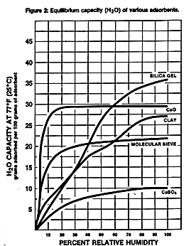

tmorris9: I assume your talking about sillica dessicant THe problem with this stuff is that it doesnt absorb much water, This is especially true when trying to maintan very low humidity.
See :[www.sorbentsystems.com]
So if our goal is say 5% RH you can only use about 5% of its absorption capabilities. This means you need 20 times the amount of dessicant.
