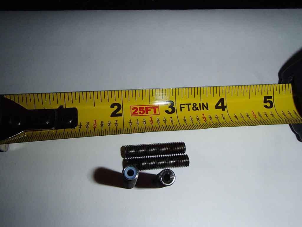

What is happening is the PLA is swelling from the creep up the barrel.
After hundreds of hours of trying to get PLA to run through the QU-BD extruder I installed PTFE tubing in the barrel.
[www.buildlog.net]
I have made some one piece barrels and Mike has them for sale for $15 each. Email Mike at
mike at thewoodworker dot net
Rodney

While I am waiting would this be an issue with ABS? I imagine the higher melting temp would help with the creeping.
