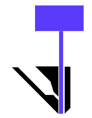

Rather than pushing the granules in to the extruder chamber, melt them in a preheat chamber first and use air pressure to force the molten plastic through. You would need to put a valve of some type in the nozzle. I’ve been working on a couple of ideas for this that might work for liquids and also molten plastics and give a cleaner “switch off” on the extruded output.
Re: mechanical engineering
September 10, 2009 06:44AM
Would a nozzle like this work? Basically a pin driven by a solenoid to start/stop the flow. The feed could then be pure liquid forced in via high air pressure.
Edited 1 time(s). Last edit at 09/10/2009 06:45AM by jpcw.
September 10, 2009 03:03PM
Something like this has been successfully tested by Adrian, it was working the other way around with the solenoid wire going in from the side.
[blog.reprap.org]
September 11, 2009 09:18AM
It tended to leak, iirc.
