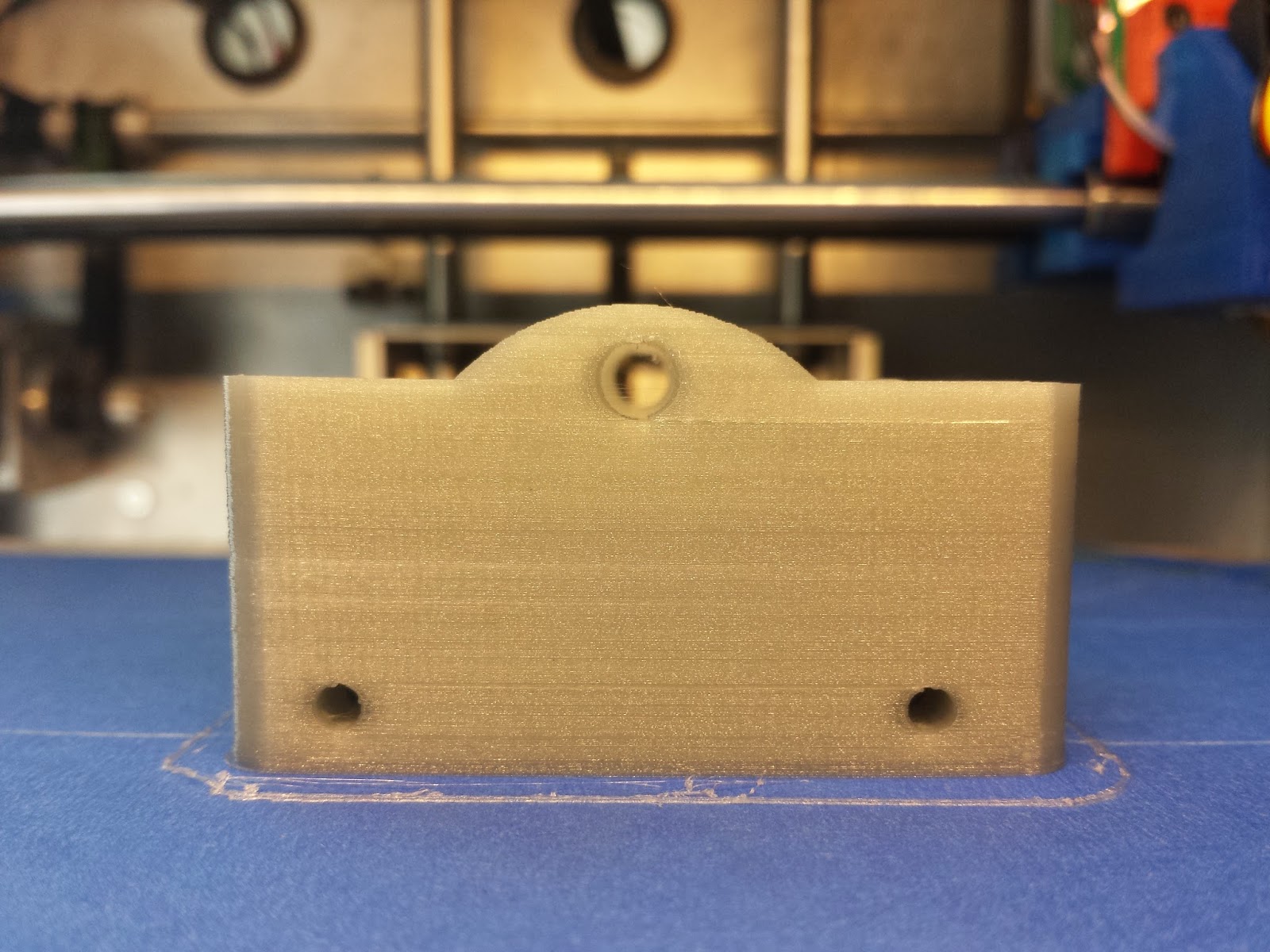

I just did a Dragon I got off thingaverse in ABS.not that high of a resolution I used a .2985 layer height came out very good little cleanup and I just sprayed some clear lacquer on it now when it's dry post a picture of it was a six-hour print when I was cleaning it up I did snap the tale myself not when it was printing but while I was cleaningQuote
MrDoctorDIV
You've shown your printer and extruder, but I don't believe I've seen prints you've done.

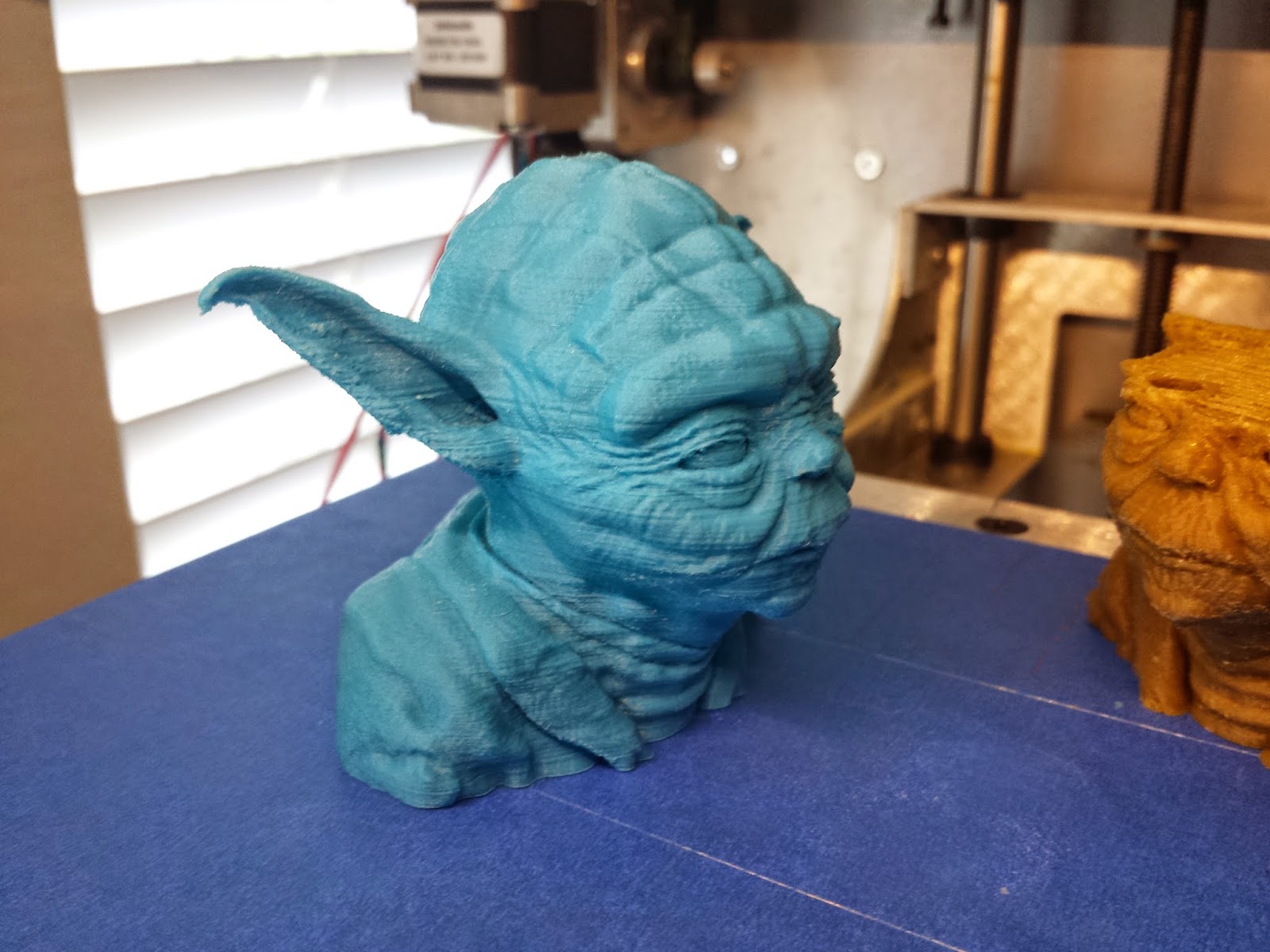

sorry I have thrown a little 20 mm test cubes away this is how you set the machine up yes it produces accurate straight walls if you think printing a square cube is easier than printing something like the Dragon I just printed your out of your mind if it's not set up exactly it will knock the legs off before they are attached to the body the tail will come out terribly never mind the wings I've done Stratis gliders which are difficult because there only one layer thick wings. I've done the screw cap Bottle test and multiple squares but obviously I didn't hold onto these. And the Yoda was printed on a larger machine that I made a couple years agoQuote
tkole
The yoda is definitely nice, but these objects don't give a good measure of a printer's capability in my opinion. I want to see an object with flat vertical faces and sharp corners. All of the curves and irregular borders mask the limitations of the printer.

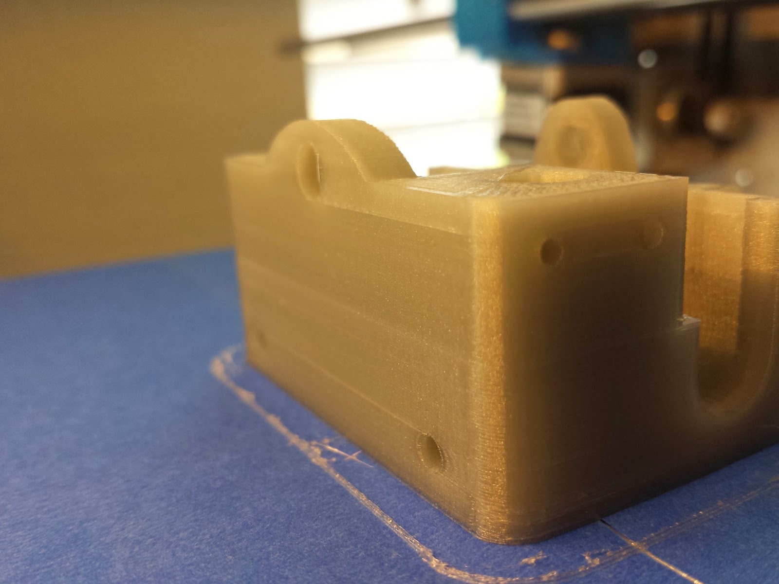

I agree I think most problems with the reprap printers is exactly what you said throwing the mass around that's why you have to build the system sturdy enough to take the acceleration and deceleration of the X or light enough which I don't agree with because the extruder and hot end is the most important thing I don't like Bowden personally. I think The main problem with most reprap designs is z guide system and the frame. This is another picture that people hate to see here this was done on my large floorstanding machine I made a couple years ago very strong very accurate all ballscrews. I did print one of these these on my new little machine with belts and it didn't come out anywhere near as good as this but still better than most i gave it away to somebody that was at my house the picture is from the large machine URL=http://s1333.photobucket.com/user/richard_nelson1/media/IMG_7886_zps7e95bf6e.jpg.html] [/URL]my large machine with ballscrews look at the layersQuote
tkole
It's not so much for the hole as it is for the inertia check. You can unmask many acceleration issues by throwing a hole in the path of a vertical wall. With the mass of your xcarriage and bed, I imagine printing this piece would be very telling. I'm not sure why PLA vs. ABS has anything to do with the discussion.
