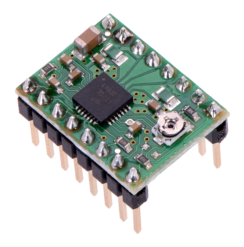

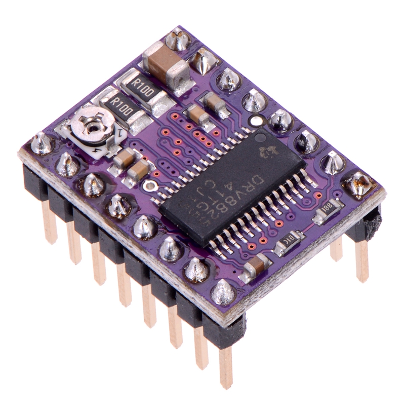

.55V for 1.7amp steppers may not be the best value. With authentic A4988 (or equivalent) Pololus, the sense resistor is .05 ohms giving the formula I_TripMax= Vref/(8*Rs) = .55V / (8*.05 ohms) = 1.375 amps. If you have Stepsticks, they have a sense resistor of .2 ohms so I_TripMax= Vref/(8*Rs) = .55V / (8*.2 ohms) = ~.34 amps. DRV8825 drivers the formula is simpler with the I_TripMax = Vref * 2 Ohms = .55V * 2 ohms = 1.1 amps.Quote
Capinho
I set my Vref to 0.55V.
