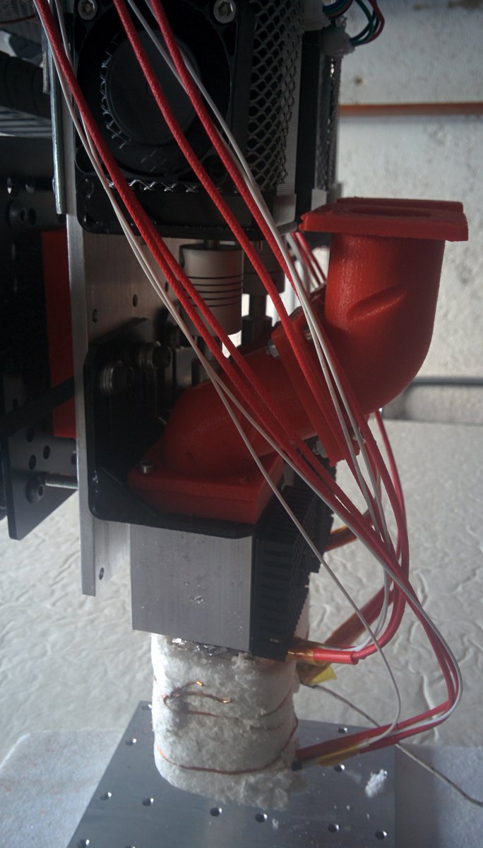

July 04, 2016 06:20AM
Ciao,
just wanted to update on my progress on the big printer with dual pellet extruder.
The progress has been slow since I ordered various pieces at different times and it slowed the process.
Also did some mistakes ! smiling smiley
Anyway, got all the pieces and changes a bit some.
The blocks are now aluminum instead of stainless steel for 2 reasons, first needed a bigger block to heat up the tube with pellet and drill bit and second steel sucks at heat conductivity.
I am doing some tests to fine tune the marlin firmware, here is a picture of the extruder
So right now I am having some issues to heat the aluminum block which is 50mm height and it cannot go above 210C !
My resistance 3.8 ohm cartridge heater is 12v 40watt 50mm height, got it from Alibaba.
I performed PID Autotune and got the following with a M303 E0 S200 C8 command: Kp: 57.84 Ki: 1.31 Kd: 640.15

Re: pellet extruder??
July 04, 2016 10:53AM
Looks nice! You might need a second heater cartridge or a larger first one, that's a big block to heat with a 40w cartridge. Maybe insulate the block with glassfibre wool, or something, you must be losing a lot of heat from the large surface area.
Simon.
[www.precisionpiezo.co.uk] Accurate, repeatable, versatile z-probe plus piezo discs, endstop cables, pt100, 50w heaters. PT1000 cartridge sensors plug straight into duet boards and others.
Published:Inventions
July 04, 2016 11:46AM
That's my next move as to use some type of insulator to keep heat on the block.
Also tried another cartridge 30mm and could reach 218.
Looks like the one I ordered from Alibaba 50mm specs are off.

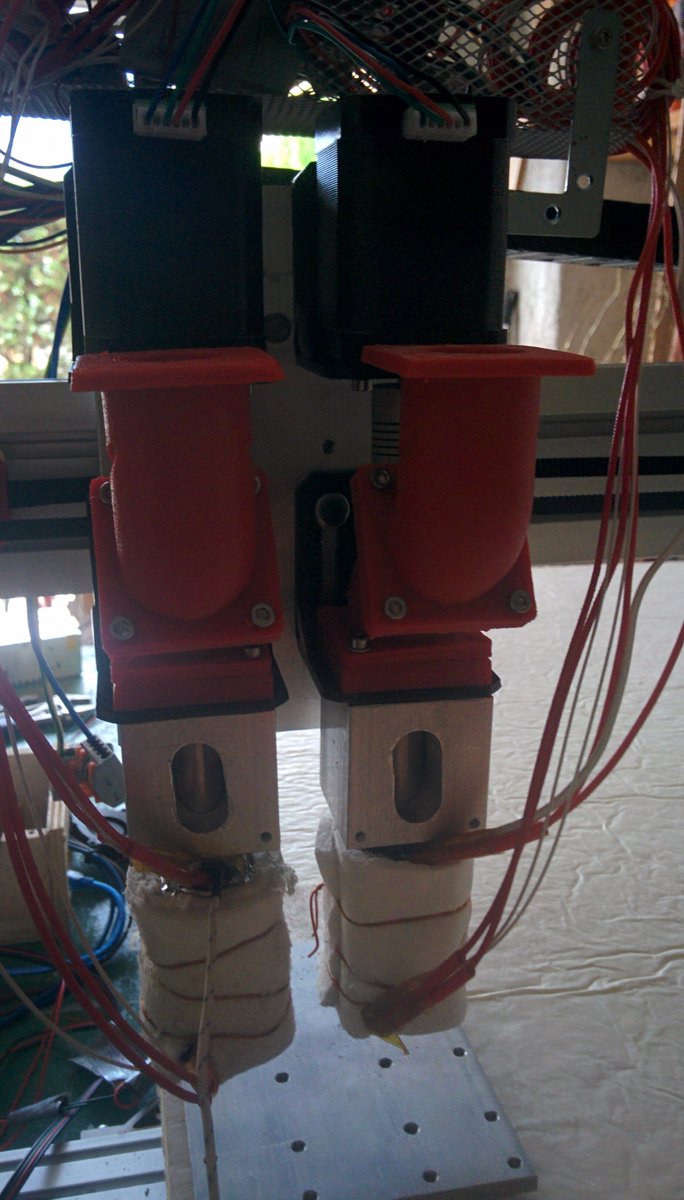

Ciao,
just wanted to share the latest build of the dual pellet extruder
Edited 1 time(s). Last edit at 08/08/2016 08:48AM by biskero.

October 07, 2016 05:51PM
Ciao,
just wanted to share an update on the pellet extruders which changed a bit from the pics above.
I can extrude HIPS pellets but I am having issues with carbon fiber pellets which are half the size of the HIPS and my guess is that they float instead of been pushed down.
I will post some pics as soon as possible but if anyone has any suggestions please let me know.
Thx.

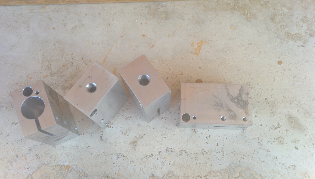

May 18, 2017 01:24PM
Ciao,
just wanted to share an update on the pellet extruder.
I redesign the hotend aluminum block since the previous one had some issues.
Now is thinner 20mm and has clamp style lock for the stainless steel tube that goes into the block.
Also reduced the nozzle M6/M7 screw height from 13mm (vulcano style) to 7mm standard nozzle screw.
In addition I ordered some new stainless steel nozzle M6/M7 with 3mm enter hole which I will enlarge.
Edited 1 time(s). Last edit at 05/18/2017 01:24PM by biskero.
June 08, 2017 07:27AM
Hello,
just an update on the pellet extruder, I received the aluminum block updated as the design above, they look nice, next some testing
