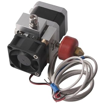

cozmicray
The red stuff around heating element in pix
is Silicone rubber
NOT ceramic
cozmicray
? What extruder hotend is Lander using?
cozmicray
aerogel insulator
