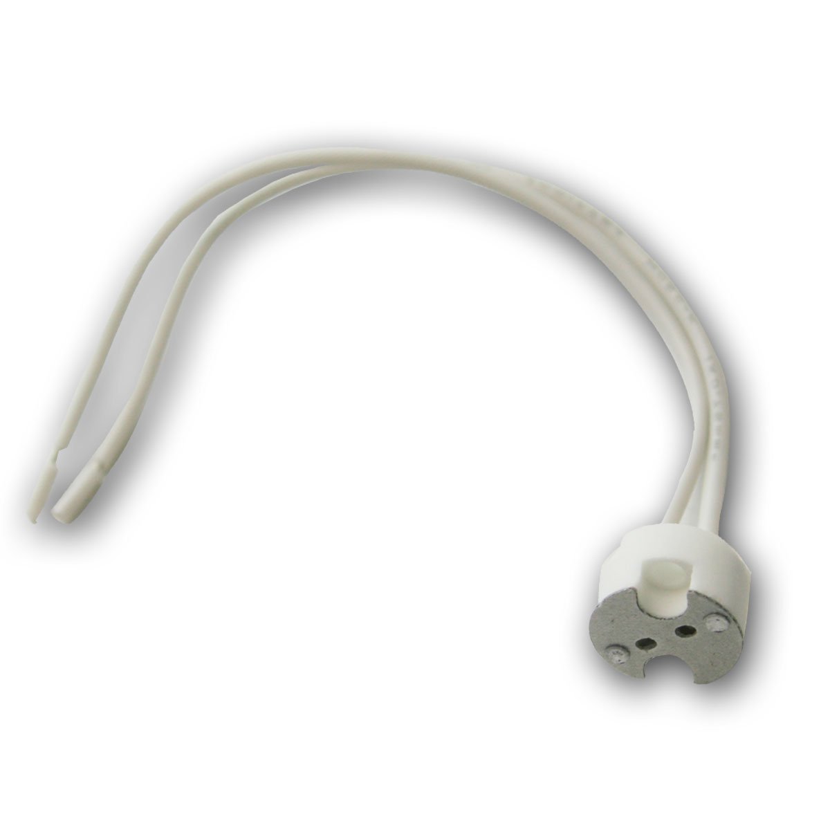

LEDs are not the best choice for a load. They require an dedicated inline resistor.
Parallel wiring the rails work, as already mentioned.
Some people use 12V( 20-50W ) halogen light bulbs as load. You have to find a suitable socket and a secure place to mount them.
-Olaf
