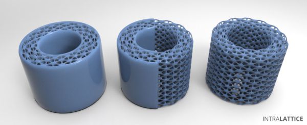

Of course I want a reliable printer as much as the next guy but I read a lot about high-tech materials that are in chemical composition (composites, nano-fibers infused plastics, etc) and in shape (like I said: micro-lattices, organic hollow core based on the expected loads and forces, etc) and I wonder where would we be if those wouldn't be left for aerospace/military use only. If we set our minds on the comfortable side of the industry innovation will stop. Granted this approach can be as expensive if not more expensive than building with metal mass-manufactured parts, but for those we are just starting to payback the costs of pollution from its manufacturing, costs that were hidden from the final price as the environment took a huge chunck out of that price.
Let's try and take a e step back and discuss possibilities, come up with things to experiment with. Of course first plastic parts used for Prusas and other repraps were not intelligent. The 3D printing has changed a lot in the last years but if we go metal we will never even see the true potential of the 3D printing intelligent plastic components and all the reprap will happen very slowly if at all. And we can always rep-strap it at the begining because some materials are way more effective to be mass-manufactured at this point.
I don't want to talk philosophy only in this thread. Let's try some brainstorming and let's copy from the high-tech industries.
For example we can easily print honeycomb structures. Also truss beams could be 3d printed.
The strongest panels out there are made of a quite rigid honeycomb structure glued to a non-strechable sheet of some sorts for the faces. It is usually aluminum (as in singcore's patented product). What materials can we use for these skins? I don't expect any reprap 3d printed out there to be able to 3d print in carbon fiber like the MarkForged but embedding a criss-cross of carbon fiber filaments in the plastic used for the skin would make it quite non-stretching. What about rep-strapping it by printing the honeycomb panel with a outer skin made of the same material and then gluing or applying some sort of non-stretching tape ontop (aramid maybe)?

Good points JM and I don't want you or any others to get me wrong, I don't want to reach a dead end either smiling smiley.
My point is, like you have briefly mentioned, that new materials come out every day, each made for different purposes. I want to apply what the high-tech industries already do with composites to our reprap philosophy. They build lattice panels out of carbon reinforced plastic for some time already. There are nano-cellulose infused plastics coming our way to overcome the heavy toll on the environment of the petrol-based carbon fiber so there will be options. But if nobody prepares for that, even with less good materials, then the trend will be set and everybody will go that way.
Regarding the embodies energy of metal plus the energy spent to machine it I don't think one can even compare with plastics, especially the non-petroleum based ones.
Also I am not a fan of a myriad of machines doing very specialized jobs because you scale that up and you end up at the situation today, the mass production. I believe that we need multi-purpose machines that can do as many tasks as possible to get some raw materials to their final form, all in one pass if possible. Of course that current 3d pritners can't do CNC that will always remain in the realm of heavy duty machining and few people will have CNCs at home. CNC and Laser Sintering and Water Jet Cutting those are for shops/ mini factories. While 5 axis 3D printing, light duty milling, laser cutting and DLP, and pick-and-place for electronics/metal parts/etc will be done by a single machine at home, hopefully one no bigger than a cupboard.
For the purpose of this thread, I hope I made myself understood and that we can continue going forward with the kind of ideas you expressed in the latter part of your post.
Multi-material one-pass gear is a great idea from both noise reduction and strength pov. Also one could replace the worn out crown instead of the whole gear, maybe while the gear remains attached to the part, no need to unscrew everything. Can this be done with dual extruders and with the technology we have today on repraps? Or maybe we can put an already 3D printed part in a DLP machine and have the laser build the perimeter structure around the part with very fine detail and maybe strong (expensive) resins, using much less of them in the process.
I'd like to see electroplating for strength not only for design. 1-5mm of electroplating mass of a hard metal over the contact surfaces would greatly increase the lifespan although maybe it will be more difficult to recycle at the end of the parts life. I think this too is possible without too expensive equipment. It is already done by Stratasys.
I would really like to see how can we print organic shaped "honecomb core" / "corrugated" / "micro-lattice" shells for the exterior surface of the parts (ex: http://wiki.theprovingground.org/april-14th-2010-space-truss). You can't mass produce such things and that's why I believe we need to dive in the details of designing such parts. We can use the process to build the frames of the repraps but the technology is not limited at that. We can't dismiss it as a valid process to build repraps frames just because we can't see other uses for it. What about replacing aluminum extrusions with isotruss structures made of some fiber-reinforced plastic? I don't know if it's possible or cost-effective right now but it will never be if we don't push thinking in that direction.

I believe we should really take advantage of the celullar structures, especially the micro-lattice variety Injection molding can't do closed cellular chambers while 3D printing can. 3D printing can also vary the sizes or the concentration of the cellular chambers based on the expected stress (for example the Voronoi lattice). I think that slicers should include such algorythms as to transform the surface of the object in two separate surfaces linked by a cellular/lattice network of spikes which would maximize their strength.
Here's an image of such a lattice cylinder:
Edited 5 time(s). Last edit at 11/03/2015 03:24PM by realthor.
