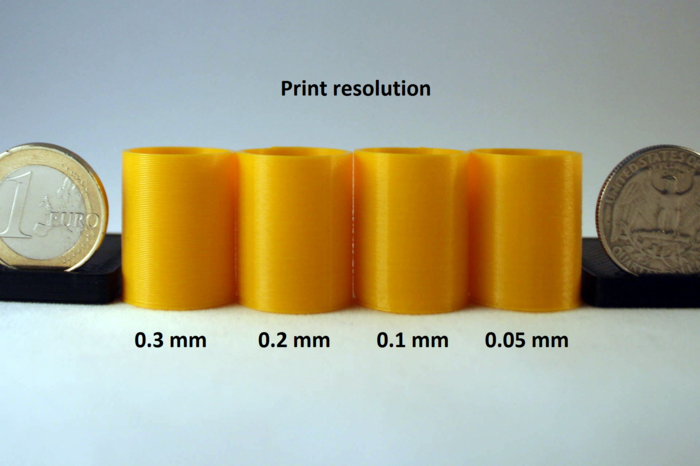

etfrench
p.s. I think your initial premise about the resolution of 3d printers being .1mm is wrong by an order of magnitude.

etfrench
Here's a source for honeycomb aluminum panels: [www.aliexpress.com]
