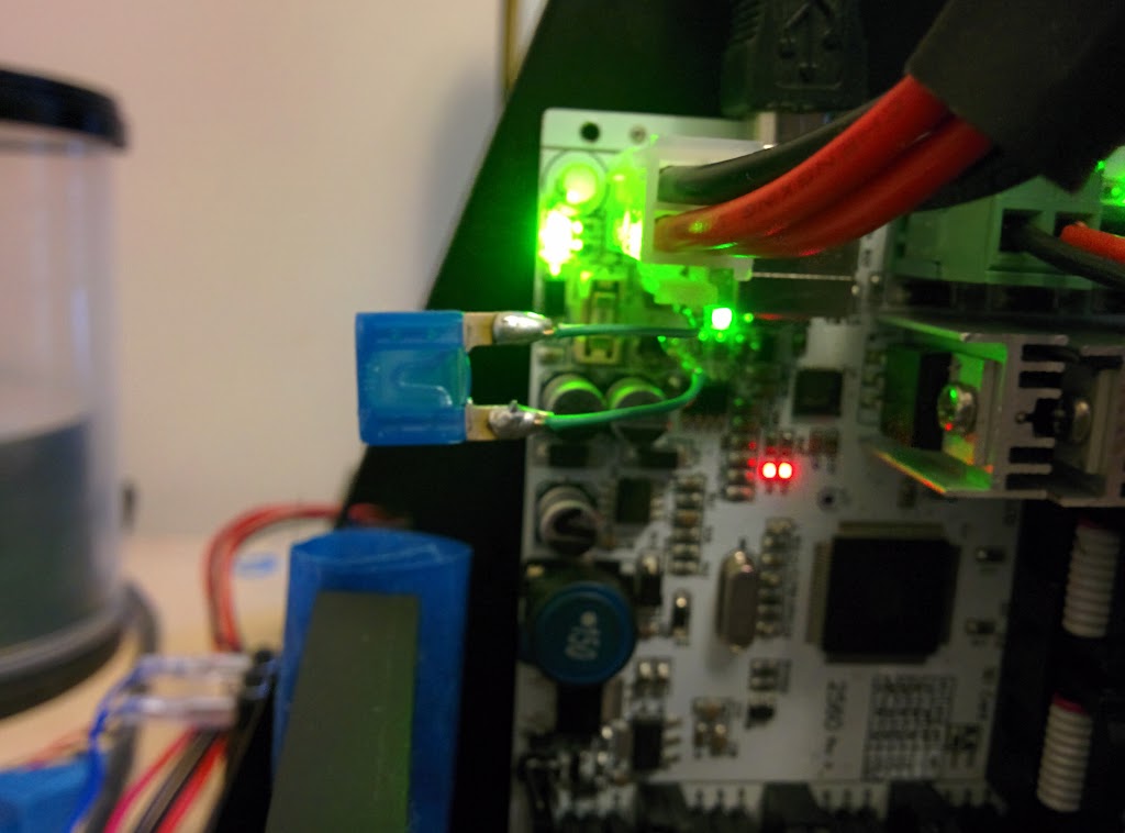

That fuse is only for the heated bed. Mine blew too, but I don't think it was from over current. The SMD connector soldered to the board was not making good contact so the fuse got really hot and I think damaged the fuse and the holder. I ordered replacements from ebay:
[www.ebay.com]
[www.ebay.com]
While waiting on them to arrive, I soldered a 15 amp automotive type fuse to the board via a couple of short leads. I'm not by the printer or I'd snap you a picture, but the fuse worked out so well, I have yet to install the replacement socket.

I just had the same problem with this board. I think the fuse holders are probably not rated as high as the fuses? the fuse is 15A
The fuse was fine. Just the fuse holder caught on fire!
I just soldered the fuse to the board. Working great again now.
First problem i have had with this GT2560 board.
Its been printing non stop day and night for a month now.
BTW I print with the bed around 90degrees, it may have contributed to the load on the fuse?

Besides the fuse, I've had no problems with my board. I'm home now so here's the picture I promised:
