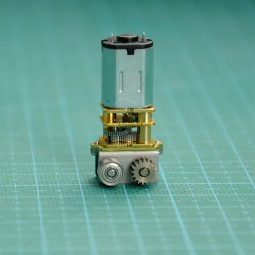

matthock
Progress report:
75:1 Pololu motor experiment has thus far failed. Not enough torque - it can run the filament in an aggressive extrude/retract cycle without the hot end for ages without the heat problem with the fan mounted on there, but once you add the hot end, it stalls.
Part of it may be the geometry. When I shifted the motors to the inside of the filament paths, I think it made things a bit too tight - it bites the filament too much, cuts notches, and these are catching on the hot end side of the PTFE path. That's not really a fixable problem with the 30mm design, so I'm going to need to revert to the older 40mm design so that I have more flexibility with the hob positioning relative to the filament path. I'll see if this is enough for the 75:1 to work. If not, there is also a 100:1 I can try as a midpoint between the known working 150:1 and the so far not working 75:1.
Another possible path of exploration is finding a way to retrofit the encoder onto the Pololu 20D motors, which are still compact but significantly more powerful than the tiny ones. They use 130 sized motors, so I may be able to scrounge up a dual-shaft 12v 130 motor to replace the stock one and be able to use an encoder more easily. This also might ease the pain of replacing it when brushes wear out, since 130 motors are only a couple of dollars each if you don't also need to replace the gearbox.
I've also been doing some more research into the idea of using a brushless motor. Attempts to find a small sensored brushless have thus far not worked out. Smallest one I've been able to find is 380 sized, which would be a lot larger than the Pololu motors, but small enough to be worth trying... except it isn't produced any more. Smallest active production one I can find is 540 size, which would be heavier than just using a NEMA17 pancake stepper.
However, I did find a part I'd like to play with - the DFRobot FIT0441. It's a pre-canned brushless gearmotor/controller combination with feedback which comes in at 69gm. Unfortunately the feedback isn't quadrature, but it may be close enough to be worth a try.

roboprint
Almost complete solution (except encoder). Steppers for gearboxes of the same size are also available on Aliexpress (I have provided the links above on this page).
Its wrong way.Quote
roboprint
P.S. popular RobotDigg site selling this motors for $7: [www.robotdigg.com]
P.P.S.: motors with encoder. It seems for me that it's possible to transplant extruder part to this motor:
Marlin (steps/dir) -> Stepping driver (steps/dir) -> Stepping motor(rotate)
Extruder with LENGTH/DIR logic: Marlin (length/dir) ->| FCM board (dir)| -> DC Motor | | <-(length/pulse) Encoder FCM | <-(alram) FCM board
