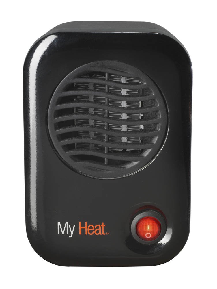

October 28, 2016 07:28AM
I am in much better shape now, adding the enclosure allowed the printer to maintain the 100c bed temperature. My generic Kapton tape from Amazon also worked great although it was really hard to get it flat without wrinkles. The enclosure ramped up to 115F during the printing. My layer height is .2mm and I made the bottom 6 layers thick. I am using 10% fill with a honeycomb pattern. The bottom is still slightly warped. What is the next step? Should I increase my bottom layer thickness? Should I try a 110C bed temperature again now that I have the enclosure?
