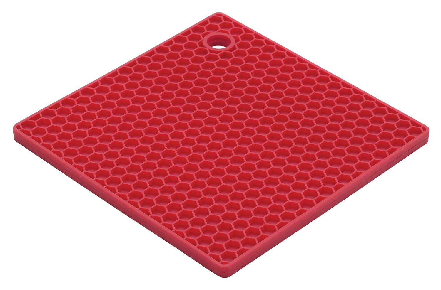

I'm thinking of sandwiching a Silicon Trivet under the bed
these are cheap in Home Bargains, but wouldnt mind one of these honeycomb ones in Black
(with laser cut perspex) to keep the heat up/even, (maybe one ontop during warm up)
but doubt i'll be going above 60 for a while. still contemplating XT60's or something for quick change...of relay/mosfet to other machines. not sure what wires/connectors i'll use for the signal, i have some JST connectors so probably them.
