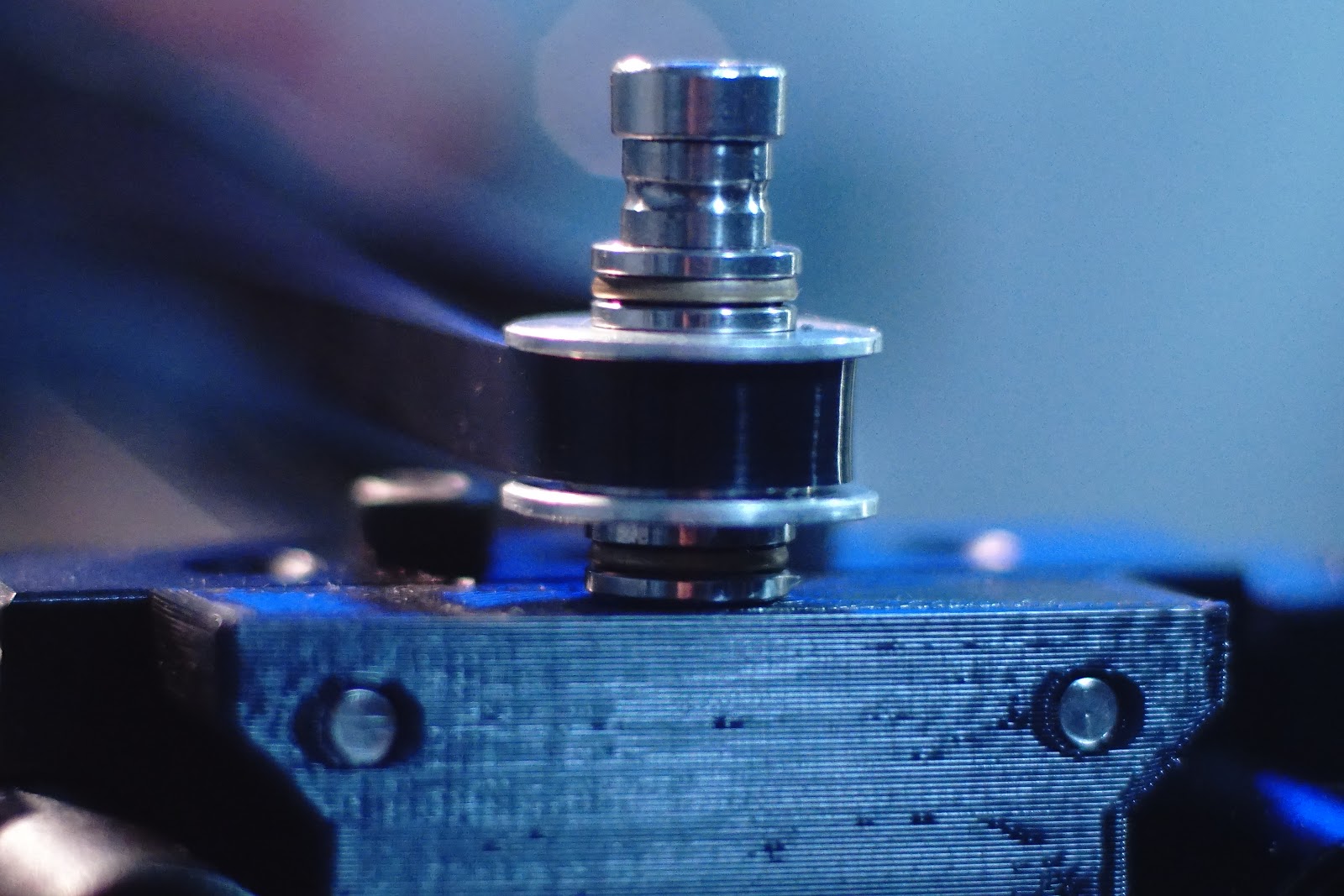

, need another print surface, normally get the MK3b...even though i'm yet to wire any of them up, but I noticed a slightly larger heatbed but one that still has holes in same place as standard heatbed...so I can use this build plate with it...though for £20 I might as well treat myself to some cast plate 300x200 though perhaps not on 8mm rails, easy swap for 12mm rails though, I've a couple of little pieces to print still for it but just small cable guide & belt clip thing. I have some pics where I have a brace between rods at top but they restrict print height, and it looks much cleaner without, i mounted the extruder at top of rod same method as Z motor.|

@Olampe, your right on one thing about the bar on the right, it stops any unwanted movement, it is passive and doesnt bind, most of my other printers have rods to the right, ie 2 rods near each other, i've been told a few of them would rack too. The other new arm I have will have 2 rods closer to each other, with the rail coming out from them.
@MKSA The Prusa with all the threaded rods is the one I was singling out, I dont deny it makes a strong frame, with lots of pieces( & looks really bad especially when the metal dulls, nasty), Sometimes the Evolution is less parts more refined, not more parts & complexity. I have a brace for the top, but dont think it needs it, the mounts the rods are in have 2 grub screws to lock the rods, If I made my own base, I would try to loose the mounts I have, and just have holes in a thick worksurface, and if that wasnt good enough, i'd introduce a few rod ends top & in recessed worktop bottom, or just put base on some feet so I didnt have to make a recesses.
Many other printers gain rigidity from the desk they are place on, why not have 2 holes in your desk...then I dont need the piece of wood.
Also the clamps I have 2 with Rods & 2 without, the ones without are used as feet, but I could use them for some buttressing, but it would be more vertical rods, and i'd have to make more of a box, more work to do diagonals.

to try out the ideas spawned, the ideal would be one each side rather than the 8mm Z, so it isnt what I wanted to do with the rods but it's one of the possible futures that have opened up. Will probably use the long 12mm Flange Bearing, instead of the shorter one, and instead of using both...though I still feel I should design the part that uses both, just incase... though thats probably a dead end, better to keep things symmetrical. Nice dark blue couplers arrived 4x one day 3x the next, must have ordered twice?|
