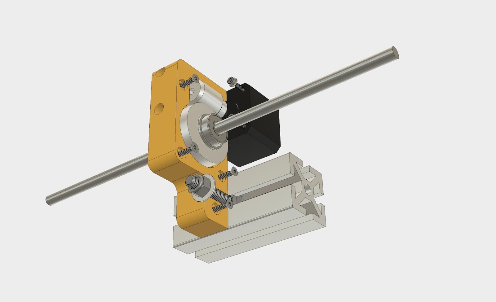

I do this sort of thing once in a while. What I find works best is to first make CAD models of all the non printed parts, including enough detail as needed to mount and align the parts. You'll need a decent caliper! Then I make as many test prints as needed to set spacing between things like gear shafts so they will mesh properly in the final part design. Depending on how big the item is, you can often make multiple test pieces in one go with the spacing or hole sizes varying. Designing printed parts for accurate alignment often involves connecting multiple printed parts to each other and you have to ensure alignment is accurate. I usually add bosses with mating holes to ensure that the printed parts will line up with each other and non-printed parts. You can add steel pins that fit tightly in holes to ensure accurate alignment of parts, too.
More here
When I designed the worm gear boxes, I printed some test pieces with slightly different spacing between the shafts to ensure proper meshing. In the sand table project, I used a "square" aluminum tube for the X axis and it had to fit tightly into the Y axis bearing blocks, so I printed a part with a series of rectangular holes of different dimensions and then tested to see which would fit the way I wanted. In designing belt clamps that fold the belt and mesh the teeth you have to have the right slot width, so I printed a piece with slot widths from 1.0 to 3.0 mm in 0.1 mm steps. Now I can just use that part to check whatever belt I'm using (it always varies from one manufacturer to another) for the necessary slot width to hold the belt securely.
