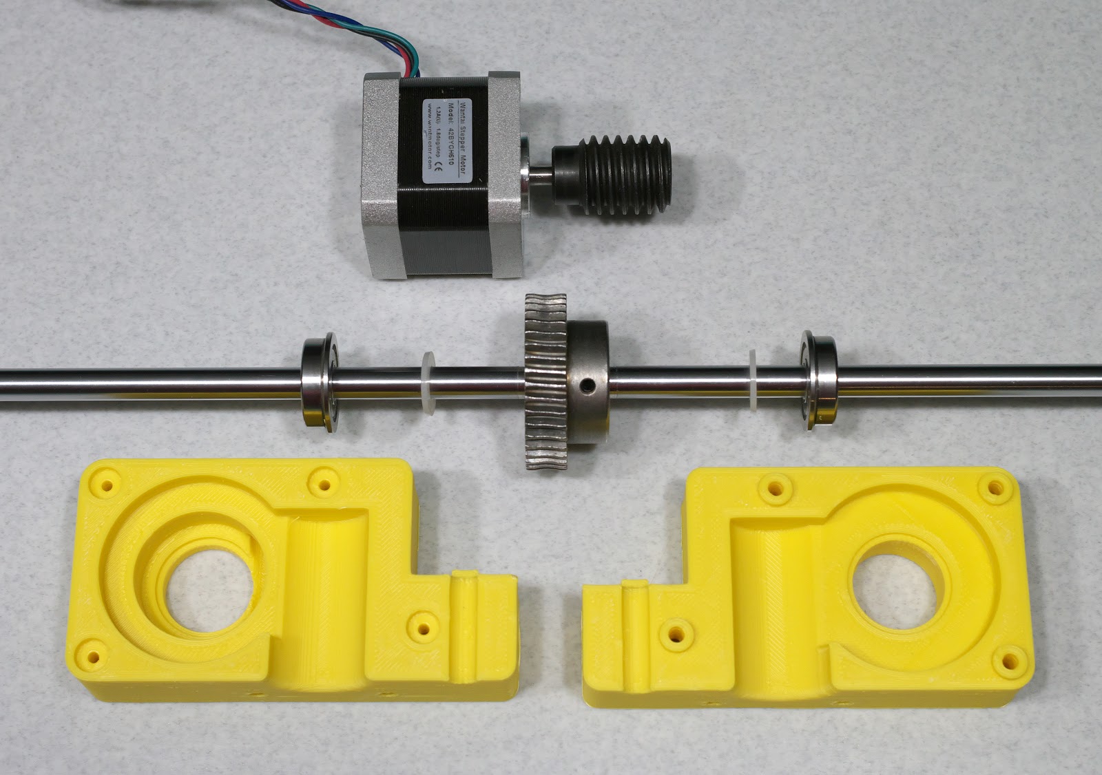

One of the early versions of the Z axis in my corexy printer was made with a single belt lifting two ends of the bed support, and had a worm gear to stop the bed from dropping.
I never tested it by printing in that configuration because I came to realize a potential problem- the bed support was hanging from the belt, and the belt was anchored on the drive pulley. The length of belt from one side of the bed support to the drive pulley was much longer than the belt length to the other side. That meant that the side with the longer belt path would hang a little lower than the other side because of belt stretch. Since the path length varies depending on the Z axis position, you can't just offset one end relative to the other. As I said, I never tried printing with it but I did measure some difference by clamping a digital gauge to the frame on each side of the Z axis. In your printer, lifting the relatively light weight X axis up a relatively short Z axis, the tilt might not be enough to make a visible difference in prints
The asymmetry bothered me so I ultimately settled on a design that uses a worm gear drive with a long shaft and two drive pulleys at the ends of the shaft. There are two equal length, relatively short, belts instead of one long serpentine belt. Stretch will be equal in the two belts as long as their tensions are reasonably close to each other. The same type of design could easily be adapted to lifting an X axis. You could put the motor/worm gear at the top of the Z axis so there won't be any clearance issues with the bed.

I ordered a Japanese 40:1 worm gear set as I didn't want to take a chance with a Chinese gear set and have irregular heights in the printed layers.
I really wanted a 20:1 set, but they didn't have those available. I figure that I can just halve the microstepping if necessary.
The worm and the worm wheel both have 5mm bores with set screws, so it should be easy to implement on the printer.

He's using this worm gear set from Ali ..
20:1 worm gear
Worm gear run in

All of the parts, shaft, and bearings have arrived for the conversion. I just need to design some bearing blocks and some adapters for the left and right gantry plates so the belts can fit in them.
Re: Belted Z axis conversion for Ender-3
April 29, 2019 02:25PM
Finished designing the bearing blocks and stepper motor mount.

I'm no fan of flat plate printed plastic motor mounts, and I'm not too sure about separating the motor mount/worm gear from the disc gear. The last thing you want is for the relative positions of the gears to change under load because that will change the position of whatever is being lifted by the belt(s). Flimsy motor and disc gear mounts will flex and do just that.
If you're going to use printed plastic parts to hold the gears, they need to be very bulky to ensure absolute minimal flex. This is what I used in an experimental printed worm gear box:
That tiny motor was lifting the 3.5 kg bed assembly in my printer at 10-15 mm per sec.
You may have to modify the layout of the machine to accomodate a really solid printed motor mount. That's life. You either build it so it will be solid and have a chance of working properly, or you do it half-assed and increase the probability of failure.

You didn't answer my question here: "Is it worth going thicker on printer beds exceeding 300mm^2?"
Also, there isn't any appreciable flex when putting weight on the pulleys.
