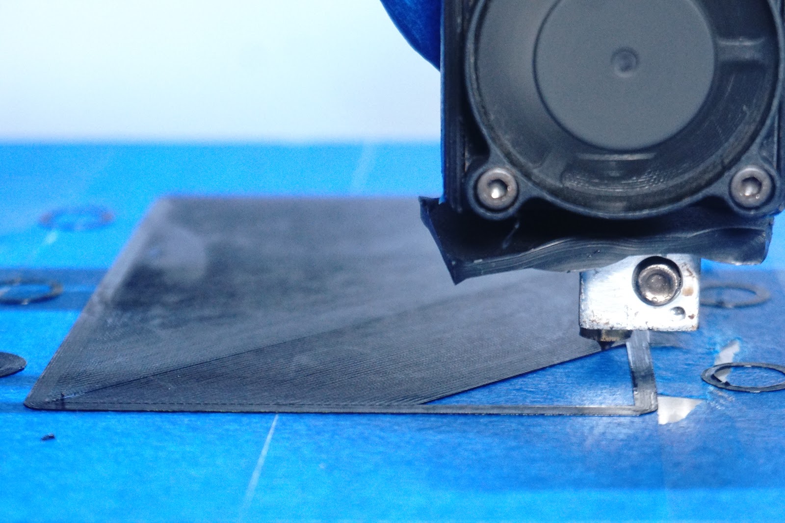

What is puzzling me is the fact that if I bring the fan speed up slowly, at 50-70% the temp curve is flat for the rest of the print. It is the initial shock that it doesn't handle.

dc42
ruggb
You can have sensitive PID parameters that react quickly to changes in load such as increasing extrusion speed or turning the fan on. But if you use those PID parameters during initial heating, you will get a large overshoot, which is undesirable. So in most 3D printer firmwares, the PID parameters are a compromise.
However, in RepRapFirmware the tuning process fits the heater behaviour to a FOPDT model, and calculates two sets of PID parameters from that. The slow-and-gentle set is used during initial heating, and the fast-and-sensitive set is used when the temperature is within 5C of target. This provides better temperature maintenance while avoiding a large overshoot during initial heating.
No other firmware that I know of uses this approach. It's still not perfect, so I plan to add feed-forward terms too.

ruggb
Yes, they are the part cooling fans.Quote
MechaBits
Do you need these fans, sounds like your talking part cooling.
I guess the best short term solution is socks.
I like the Repetier firmware solution, but that involves another learning curve.
