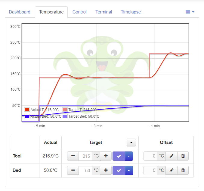

Start of the nozzle heating is not stable November 06, 2020 07:30AM |

Ohmarinus
Looks to me like the nozzle temp is related to the bed temp. It waits for the bed to reach full temp before it continues heating the nozzle. This is probably to reduce stationary plastic getting heated for too long in the nozzle, preventing clogs.
