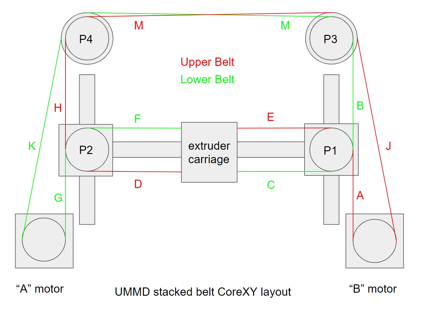

I have been looking into the possibility of building something inspired by the Voron Legacy, repstrap style. Not exactly to spec, but I think it could be done for a lot cheaper using some of the old reprap hacks. Keep the belt layout and a lot of the 3D parts, use drill rod for the linear shaft, printed PLA LM8UU bushings. Wades/J6 print head. Unheated bed to start out with. Maybe even a wooden frame.
Seems like a good mix of achievable, capable and upgradeable.
Re: Building a Mendel in 2021. What would you choose?
October 16, 2021 10:08AM
It's great that you're going to try to design your own machine, even if it is based on someone else's design. One of your goals was to learn from the process, and you will most certainly do that.
I can make a couple recommendations regarding that design. It appears to use a stacked belt corexy mechanism. Notice that right at the motors the belts bend 90 degrees and at the opposite corners the belts simply loop 180 degrees around the pulleys. If you count up all the pulleys that each belt bends around, you'll find 7 including the drive pulley. That's a LOT of pulleys, each of which adds to the load on the motor. Why not eliminate the bend in the belt right at the motor mount and simply put the motor at the opposite corner where the belt is making a 180 degree bend around that pulley anyway? That reduces the pulley count to 5. 5 pulleys vs 7, what's the big deal? If you ever get a chance to manually push a corexy mechanism around by hand, try moving the extruder carriage in the Y direction. You'll find it pretty easy. Now try moving it in X. It is much harder because that motion requires the belts to move at all the pulleys. That difference represents additional load on the motors, and will ultimately be one of the limits to speed/jerk/acceleration of the mechanism. Adding 4 more pulleys will have an effect.
The front of the frame of that design is open - it has no cross member between the two end pulleys. That will lead to a less rigid structure and problems enclosing the machine. There's no good reason to do that.
The belts/motors are all inside the frame in X and Y but stand up over it in Z. That will make it easy to put side panels on the machine, but will leave it difficult to fully enclose. How are you going to cover the top with the mechanism standing up like that? I suggest building so the vertical members of the frame stand up well above the XY mechanism to allow a flat panel to be added to the top to fully enclose the machine.
It looks like the belts are tensioned by sliding the motors a few mm in the slots in the motor mount (I'm going off the few photos here), but if the motors are mounted at the two end pulleys as I suggested above, belt tensioning can be accomplished simply by sliding the whole motor mount along the frame member and tightening it down. I built a couple sand table mechanisms that incorporate some of the ideas suggested above. You can see the mechanism in this video. I used the t-slot as the Y axis guide rails with sliding PTFE bearings, but I would not recommend doing that for a 3D printer. Stick with round rails or linear guides for the high accuracy and precision that a 3D printer requires. The point is that the mechanism uses the minimal number of pulleys, has no projections outside the XY fame, the vertical corner members could be made tall to allow full enclosure in a 3D printer built this way, and belt tension is easily set by sliding the motor mounts along the t-slot to which they are bolted without the added load of extra pulleys.
The pretty covers on the extruder are nice, but you'll find, especially if you go cheap on the extruder, that those covers are going to be in the way most of the time. The extruder is the least reliable part of the machine and you're likely to have to work on it frequently. The covers make it look nice, but add pointless mass to the extruder carriage and get in the way when it's time to clear a clog out of the hot-end, etc.
I can only see two screws used to lift the Z axis, which is fine, but hopefully they are driven by a single motor. If there's a motor on each screw, you'll have to keep releveling the bed because the motors will jump a bit each time power is cycled. That will lead to the bed tilting and you'll have to do something to untilt it. Using a single motor driving both screws will keep them permanently in sync so you'll never have to tweak that part of the bed leveling. If you want to make it super reliable, use a flat plate for the bed (cast aluminum tooling plate) and put it on a 3 point kinematic mount. You will not need autoleveling at all because it will stay level after the initial, simple, manual setup.
Don't even think about using PLA to print the motor mounts or extruder carriage. Use ABS or PETG. PLA does not belong anywhere near anything that gets warm or hot.

Yeah thanks for that! I can't say I know too much about belt layouts, I guess other corexy printers do seem to do it the way you describe? Looking at Hypercube/Smartrapcore. I did wonder why it uses pairs of flanged bearings too, instead of toothless idler pulleys. But those wouldn't fit within the printed parts as they're designed.
The Legacy actually does have a front cross member, it's just moved down slightly to make it level with the print bed in the zero position. I had assumed this was done to avoid interference or have better airflow or something, but looking closer I guess it's so that you get a better view of the print and/or can take cool videos. The 0 doesn't have one at all, but clearly it's small enough that it doesn't particularly matter - at the speeds those things print at, any instability would definitely have been picked up. And the 2.4 is a standard cube, but then it has the entire XY mechanism on a gantry and the print bed is just static.
As I understand it the Legacy isn't specifically designed to be enclosed, but there's a few ways it could be done. Could add a "top hat" style enclosure or put it in something larger. Either way there's no real need for it to be structural, so it could be added later. I will consider lengthening the frame but will have to see if it works out, from what I can see the cheapest 2020 I can get is in packs of 1m lengths.

Flanged bearings are used because the toothless pulleys sold for 3D printers have bearings that are too tiny and will wear out very quickly. Flanged bearings are better because the balls in the bearings are much larger and should last a lot longer. This is the kind of small stuff that you don't have to learn by doing - you can rely on other peoples' experience and save yourself a lot of trouble, time, and some money.
Belt layout is critical for proper operation of the mechanism! The #1 rule is that the belt has to be parallel to the movement it is creating, exactly the same as a screw drive.
So I asked around about this and it seems the motor placement on the Voron serves two functions. Firstly it removes the need to have a twist in the belt to avoid the teeth contacting one of the pulleys. And secondly it helps to maximise the available space in the frame by having all of the things that take up space within the frame on the same side of the printer - motors, electronics, power supply. I did ask why those things couldn't just be moved to the other side, and you'd turn the printer 180 degrees to get an unobstructed view of the print, but haven't recieved an answer.
There may well be other reasons, possibly related to parts of the design being borrowed from the other printers in the range, but I think you're right in that the layout you described can be both simpler and cheaper.

Twists in the belts are only needed if the pulleys are small or you want quiet operation at very high speeds. The stacked F625s used in that design are still a little small to have the belt teeth hitting them- they could cause print quality problems (as well as making zipping noise at high speed). Gates recommends a minimum of 9 teeth in contact with a smooth pulley surface, and since the belts are wrapped at 90 degrees on the pulleys, that would be a pulley diameter equivalent of 36 teeth. Belt pitch is 2 mm (a little less when bent around a pulley), so pulley circumference of 72 mm (approximately). 72/ pi = 23 mm (approximately) in diameter. F608 bearings are 22 mm in diameter (close enough!). I used stacked F608 bearings and 9mm wide belts in my corexy machine and prints are great.
This is the minimal pulley count belt layout for corexy::
I used larger pulleys in the corners to provide extra clearance for the belt when the X axis is near the corner pulleys. It isn't strictly necessary. The most important thing about this diagram is that belt segments labeled A-H must all be positioned parallel to the guide rails (in every corexy mechanism, no exceptions!). Otherwise belt tension will vary as the extruder carriage moves and prints will be distorted. There are a lot of bad designs out there! If you see a clothespin spring belt tensioner, beware! The layout is probably wrong.
See: [drmrehorst.blogspot.com]
