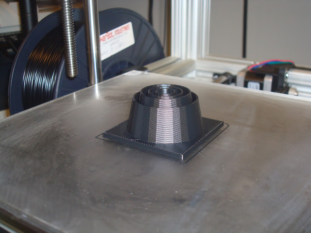

I've had really truly fantastic results with the sanded or blasted borosilicate glass, with a very thin coating of acetone/abs wiped over the surface.100-110C glass temperature (confirmed by multiple means, since everybody seems to be doubting my temperature accuracy)
I have not had a single part warp since I started to do it this way. Even things which would lift the kapton tape off my aluminum build surface in the past. I'm sure it has limits, but they seem to be further out than anything else currently in use (for abs)
I'm finally pretty confident in the why it works/how to reproduce it.
First, the type of glass. Borosilicate glass has a very small coefficient of thermal expansion. Because of this, it is well suited to take the temperature required for an ABS heated bed. As an added bonus, as the abs part cools, the part pops off the build surface (it shrinks much faster than the glass, and creates enormous stress at the build surface.)
Second, the glass surface finish. Plain glass is pretty boring, and completely 'flat' for all practical purposes. Heavy sanding or light abrasive blasting creates a surface with substantially more surface area. The surface roughness/area gives the plastic something to grip.
Thirdly, because abs is so viscous, it cannot efficiently spread into all the tiny craters/scratches created on the surface. By using very diluted abs in acetone, a thin layer of plastic can be completely adhered to the rough surface below.

Sandpaper sorta worked, but took forever and was not ideal. If you know somebody who does body work they usually have a sand blaster for cleaning rust off. I have friend who etches art glass, but I also bought a $10 Harbor Freight hand blaster which worked well enough.

I think I'm the first and only so far.
Not sure if a YouTube video would help. It looks exactly like printing PLA on a heated smooth glass bed.

Yes, the Fablicator is me ( Or I should say mine winking smiley
I assume the pics are mine, I'm not entirely sure which ones you are referring to though. You mean like this?
[lh5.googleusercontent.com]
