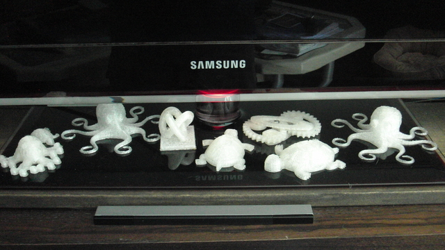

I was down for a few weeks while waiting for a new Pololu driver and when I got back to printing I downloaded this commit [github.com] to find changes to acceleration in the config file without as much as a note to how they related to the old ones and after attempting to use it I found that Xon/Xoff no longer worked so I went back to using commit [github.com] . With a lot of tweaking and a new stepper motor for my extruder I am print reliably at 120mm/s. The only thing that needs fixing is the host software. After trying RepG and Repsnapper only to have failed communications I went back to using GTKterm with Xon/Xoff. Since that point I haven't had a single issue not even a pause in the printing.
Thank you everyone for all your hard work but please keep the experimental stuff in their own branches. Teacup has reached mainstream whether you guys like it or not and putting all the experimental stuff in is going to cause all kinds of issues.
All of this was printed @ 120mm/s
