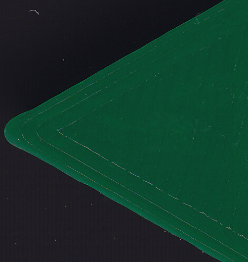

Hi there,
I'm currently using a printrboard, sli3er 9.7, pronterface and a prusa mendel from makerfarm, nozzle diameter 0.35mm.
Recently, I accidentally sent a few too many commands for the z-axis to go down... it ended up pushing the heat bed. I noticed the limit switch was out of place so i fixed that, then i noticed the bed wasn't level (probably bent the linear bar on the y-axis a tiny bit) so i leveled that off.
Now, when I print the first layer, adhesion is so 'good' that it is squished down onto the heated plate. Prior to this incident, I was printing parts that weren't adhering to the surface enough but just enough to get some pretty decent prints. So now I'm assuming the nozzle was never close enough to the heat bed.
Because the first layer is so squished, it causes the filament to kinda squish outwards then moves upwards, therefore creating a very rough first layer with filament sticking out. The bottom layer looks like this from slic3r is nicer.
What i'm trying to achieve is this again... from slic3r is nicer.
I have played with the extrusion width and the z offset. I also have my first layer height set at 0.35.
I might be playing with these variables incorrectly, corrections are gladly welcomed.

What do your first layers look like?
Mine look like this [imgur.com]

Looks like you guys were right, it did have something to do with the z-offset. But it wasn't just that parameter. I did some googling and I found this website which pointed me towards proper prints.
[solidoodletips.wordpress.com]
and
Now I have the following settings (just a few that mattered):
Layer Height = 0.25
First layer height = 100%
Default extrusion width = 0.25*1.4 (width to height ratio) = 0.35
First layer extrusion width = 100%
Z-offset = 0.18 (this WILL vary with your setup)
Hope this is helpful to anybody who reads this.
