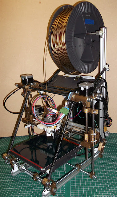

Hello everyone,
If you are planning to build a Prusa, I have just built up a full linear bearing (LM8UU) version.
Some of the pictures, advice and modifications in my Blog update may help you decide what to build or how to build it.
I highly recommend using the linear bearings and there are a few different Linear Prusa designs now, good luck.
Take a look - * Pimp my Mendel * - How to build up a LM8UU Linear Bearing Prusa
[richrap.blogspot.com]

Hi Richrap,
Very nice build and instructions!
Could you please update us / confirm about pin number connexions between the SD card board and the RAMPS 1.2? (or has this info already been written down in the wiki? last time I checked it wasn't there)

HI Lanthan
The files are on Kliment's site here - http://koti.kapsi.fi/~kliment/photos/sdramps/
With a picture of it connected
Is has a dedicated connector on RAMPS 1.3 also shown on the Wiki page below
and the WIKI page for SD RAMPS is here http://reprap.org/wiki/Sdramps
And there is a DIFFERENT SD PCB for the Sanguinololu - available from Kliment
Rich.
