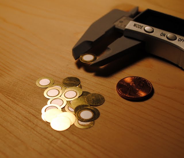

Just got twenty 10mm piezoelectric transducers off of ebay from zinky86. Hopefully tomorrow I will try powering them with my arduino and sparkfun ardumoto shield. I think it should work at powering the piezos. The delays, rise and fall times are in the micro second range, however that is with a resister. It will be something along the lines of what casainho has done.

Check it out, got the arduino/ardumoto powering the 10mm piezoelectric element. Depending on the power supply I can provide +18 to -18 volts. I can feel and hear the vibrations. Now I need to build a housing for it...
Got a question though, any tricks to solder wires to these? I broke two of them (third times the charm!), the piezo material seemed to de-laminate from the brass.

I use a hot iron with a tinned wire and solder as quick as possible, a softer more flexible wire may have less tendency to
pull off, some piezo buzzers can stand a fair bit of abuse, whilst others die at the least excuse.

If you can know the manufacturer of the specific disks you can probably find their recommended soldering instructions.
Here is a link to the instructions provided by PUI Audio: [www.digikey.com]
A link to Murata's instructions: [www.murata.com]
