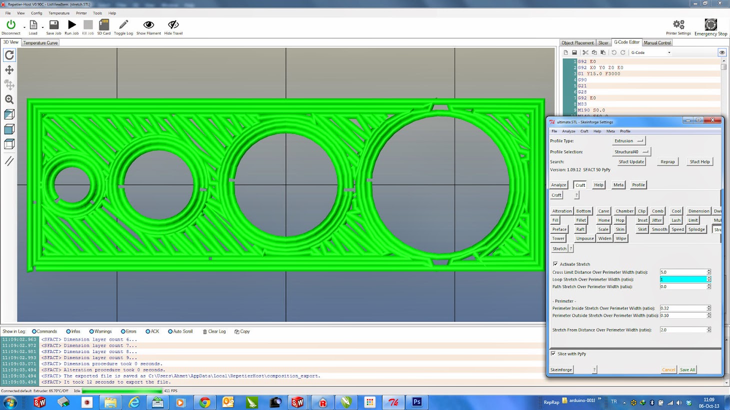

I have a stamp model where I have an issue that the top layers are not filled. It's quite thin detail, but I would still expect some infill. What parameter to chang in SF to make such parts also filled? Attached photo of the original printed object and the gcode SF creates using mostly default settings, 5% infill, 0.27 layer height, 1 extra shells (using Print O Matic, number of shells: 1). The whole circle diameter is around 4.8 cm, so it's not that big, but the details otherwise came out quite nicely.
Thanks in advance!

decrease the extrusion width so it can accomodate the fill

SF don't put an infill when it calculates there is no room for it. You can decrease layer height to get an infill in thin places, because extrusion will be thinner.
ahmetcemturan suggestion (Inset/Infill Width over Thickness ratio for infill, Carve/Edge Width over Height ratio for perimeter), depending of your printer settings, can lead to over or, in this case, under fill your object.
(To be known: increasing Carve/Edge Width over Height ratio gives a larger extrusion, it's logical, but *decreasing* Inset/Infill Width over Thickness ratio gives a *larger* extrusion… not logical at all…)

The only correct way to fill little places is by decreasing layer height… Other possibilities as changing extrusion width will break print quality…

To get those spots to fill you just need to only use one perimeter (no extra loops). Skeinforge does a thing where it only puts infill inside the inner most perimeter (loop). So since those spots are outside of the inner most perimeter (loop) it does not even try to fill them.

0,2mm layer make that holes fill. and i will try use only perimeter. but extra shells makes better fitting on bed
but strange for me is fact that hole is wide enough to put one loop inside. by me is only because SF generate loops like around infill area - when are loops in small area, not around holes. this looks like it wil be there only with space for 2 loops.

Do you speak of Skeinlayer view or really printed object? Of course Skeinlayer don't shows the real width of filament, only the path.
You must set a good value for Inset/Infill Width over Thickness, this value changes with every plastic, sometimes with the color…
Sublime, I never had good results with the only default perimeter, I always put an additional loop, this works fine for me.

I agree more loops makes for a stronger part but I also know this is known issue with Skeinforge that has no proper solution other than design the part with all areas thicknesses equal to your extrusion width times 2, 4, 6, 8 etc or print with a single perimeter. It is so well known if you look up how to print gears with Skeinforge the instructions will tell you to use a single perimeter or you will end up with hollow teeth (see [www.makerbot.com] ). Since Skeinforge is no longer maintained or updated you will either have to live with the fact you need to use one perimeter for some parts, redesign them to work with your extrusion width, fix Skeinforge yourself or use another slicer that does not have this bug. It is true you can make it extrude narrower and then it may fit all the loops but that can cause even more issues.
