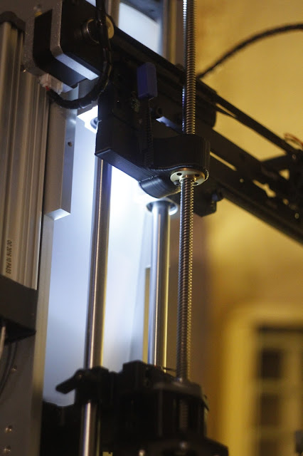

Taking shape just need one more rail for x,I one eye on the one on the XY table another eye on ebay, or have static head?
XY table might be tricky to get working, but fun to try, problem I have is driving the bottom carriage, as this is low profile, motor needs mounting somehow, into the base, but there's nowhere on the rail assembly to add anything, would like a central motor near Z base. idlers at ends of rails, there is just enough room under carriage for belt, but unless motor was sunk into worksurface it's going to be as usual the trickies axis to get right.

Use your imagination....right now its just balancing, no rail sad smiley parts are leftovers from previous design, so still have the carriage for this to do, it doesn't need the bar at the back, as belt is closer & above carriage this time, though toying with adding 2 carriage/rails for independent heads, resisting the temptation to complicate things. Wanted to use a closed belt on the X but for the sake of 5mm couldnt, motor needed to clear the bar, could have mounted motor reversed, sticking out but decided against it, ideally bar need to be relocated about 50mm to get longer X, rail could extend past end if i use the large bolts for idler. If I had custom metal Z carriage I could get things where I wanted them.
Also thinking about running a belt to the Z rod from the motor in the base, its a better one than on the top at the moment, but Z seems well constrained(works well without bottom bearing but I've added one), and is running solid, not sure if the belt would improve things

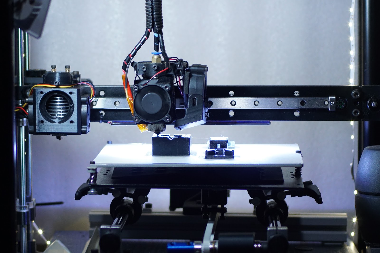

Down to last roll...first print with the reel on a better spigot, hassle free, first layer a bit low forgot to double check, it's been a while since printing stuff but trying to figure out what you really need...I have hundreds of files could be printed, but I always have to try to think about whats really needed. I need 2 of these things for either end of the twin rails, this one will have a cover so the pully's supported both ends, the other will be motor facing down...cant go too high with that motor or table would hit it...but its only to try the x/y table...not sure if motor will handle it, need a 350mm closed loop...but might be better with open belt, as I have little room for tensioning the belt.
Re: MechaBits KraftWerk'r
January 10, 2017 12:52AM
It looks like you're getting some pretty high quality prints out of that machine.

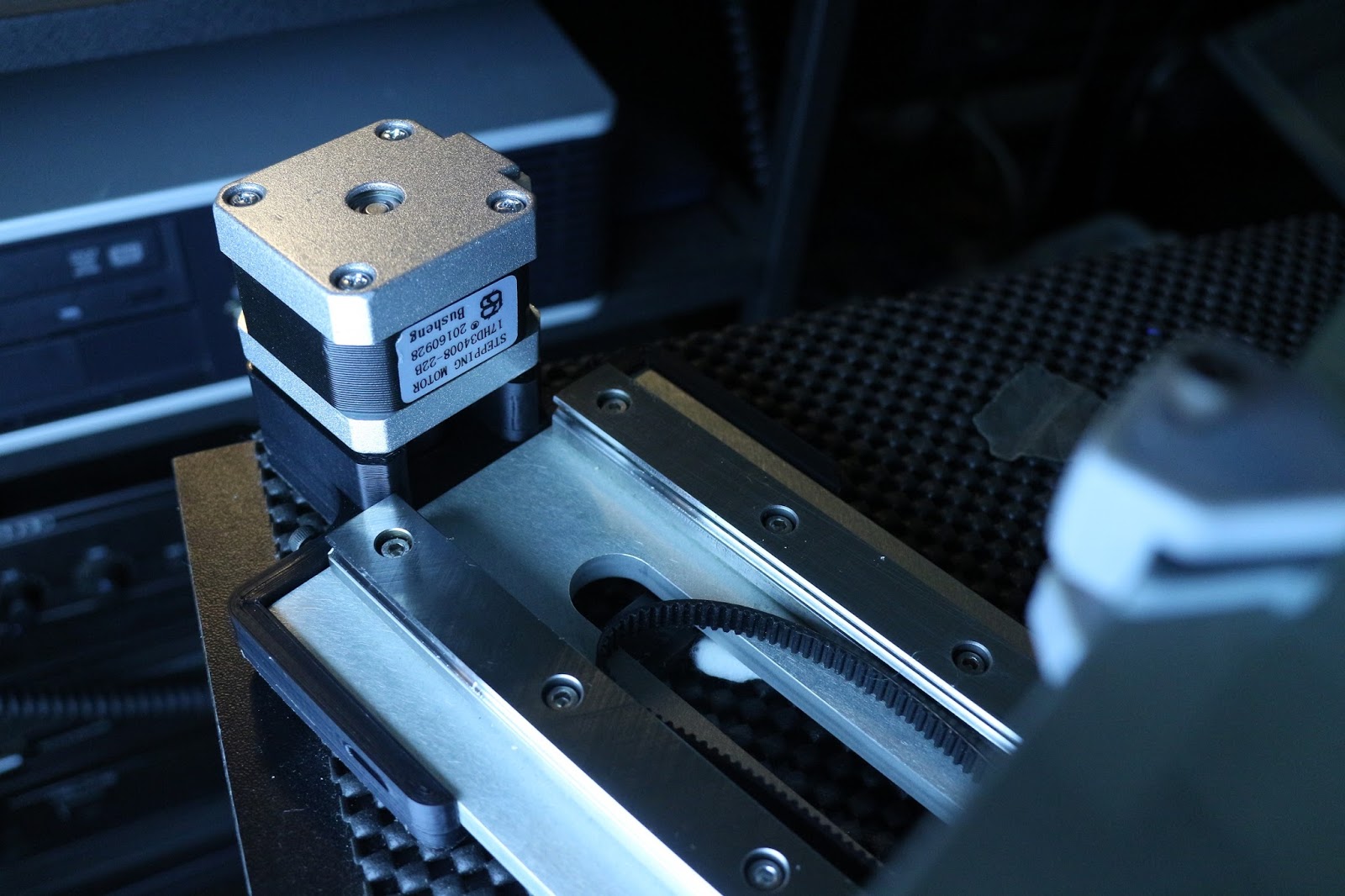

Quick XY test..need to bolt things down
[www.youtube.com]

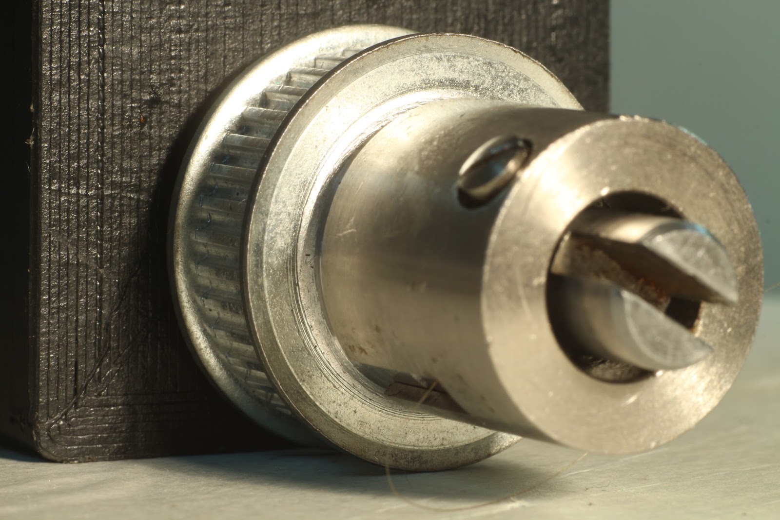

hoping to power one direction with this little nema 35, I have placed a bearing at the opposite side incase I later want to add a shaft to drive other side of the dual shaft nema35. But I'm hoping to get away without it, I'm thinking of trying to move the carraige with a belt from one corner arranged in a T shape so it goes down the Y and along the x & back to other end of Y. the belt will be 90 degrees to the other one. so working in different plane.
I ordered 2 more black rails, knowing I can put them to good use, even though they are a little too long to be used as arms on the other printers.
The pics are a bit crap as the stand currently has printer one on the top and I had to test the thing on the lower shelf, and its a bit dark down there.

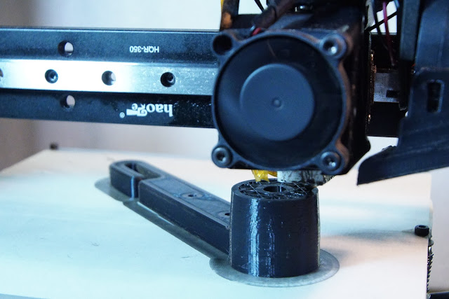

Well I'm really having trouble using up this Black, wondering which parts I really need//want in Black,
A month or more with no printing, I decided I had to do some thing so thought i'd do an alternate end idler for linear guide on the Godzilla. Though this one relies on the pulleys with bearings, an alternate design with bearing just looks a little cumbersome. Ive put the 400mm black one on the arm and its longer than my back plate, not that it matters the last portion is unsupported, though I also have a smaller silver rail with same hole spacing I might use that in the future. I have probably enough left for one more carriage plate for this machine keeping all main parts same colour.

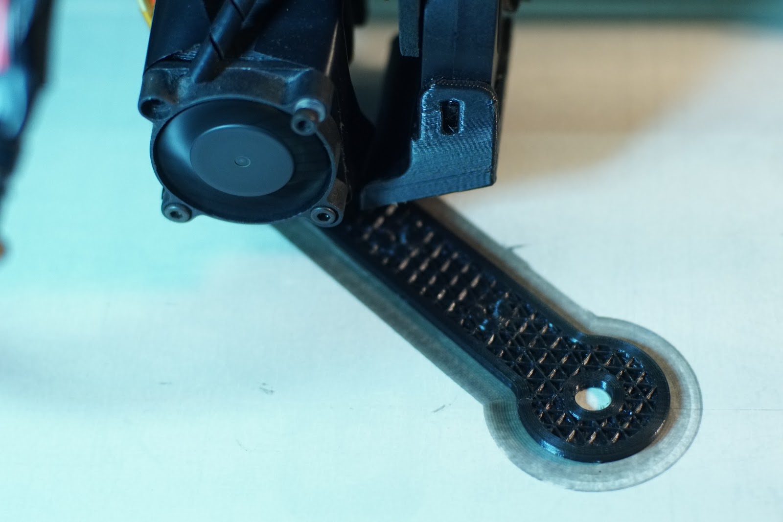

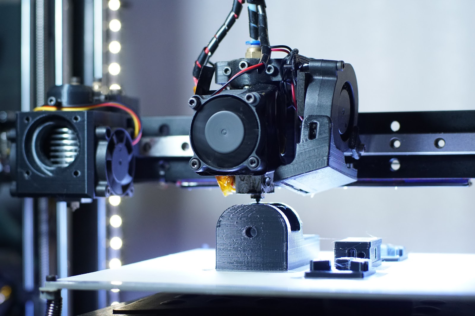

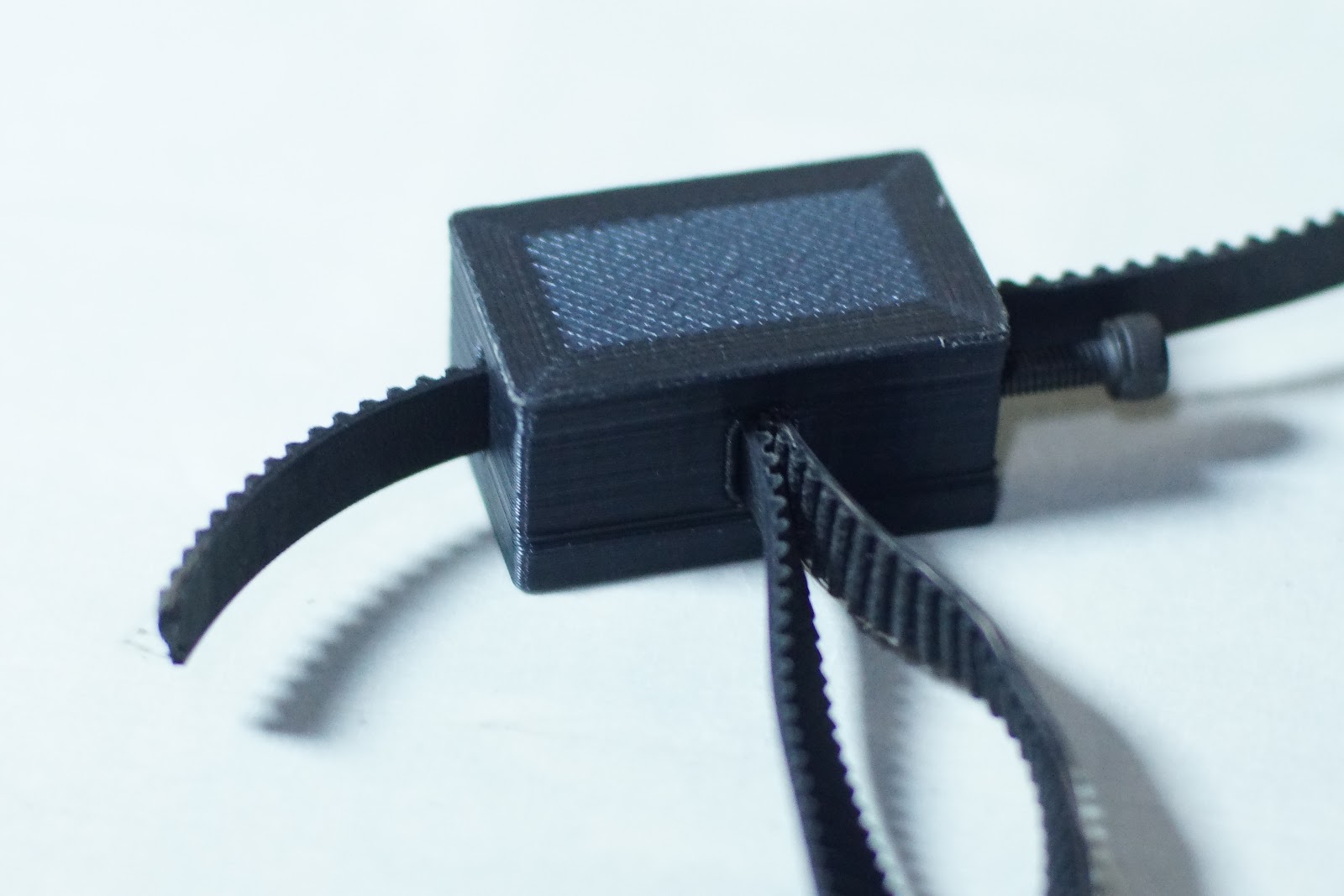

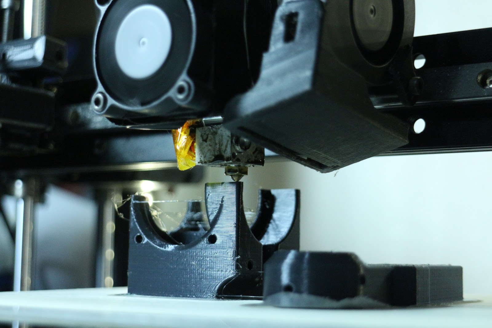

Finally got around to another part, the carriage, the problem is I already had a hotend enclosure designed, and need to mount that, plus other possible configs, god knows how many variations I have no and still not the ideal solution, just a lot of options.
So I ended up with 2 of these very cheap L brackets four joining wood, made of nasty metal, but I thought it might help to reduce the plastic & rather than trying to print 1 part carriage I can split it into smaller parts(& because of print orientation issues when trying to design the ideal one part part.
So just added the belt holder/actuator half, and another left over hotend holder, and though I thought the L brackets might be a little too bendy, all seems fine. just need to make a proper dual front for it, though the length of this arm means a hell of a lot of room for more.

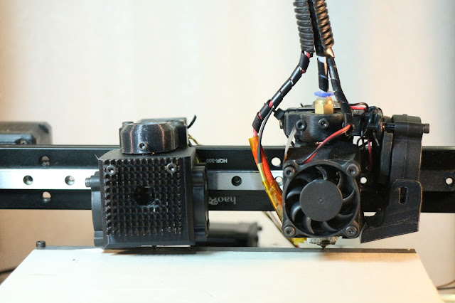

I'm thinking of a new hotend shroud / carriage,
Needs a little more work want to split it up to a number of parts.

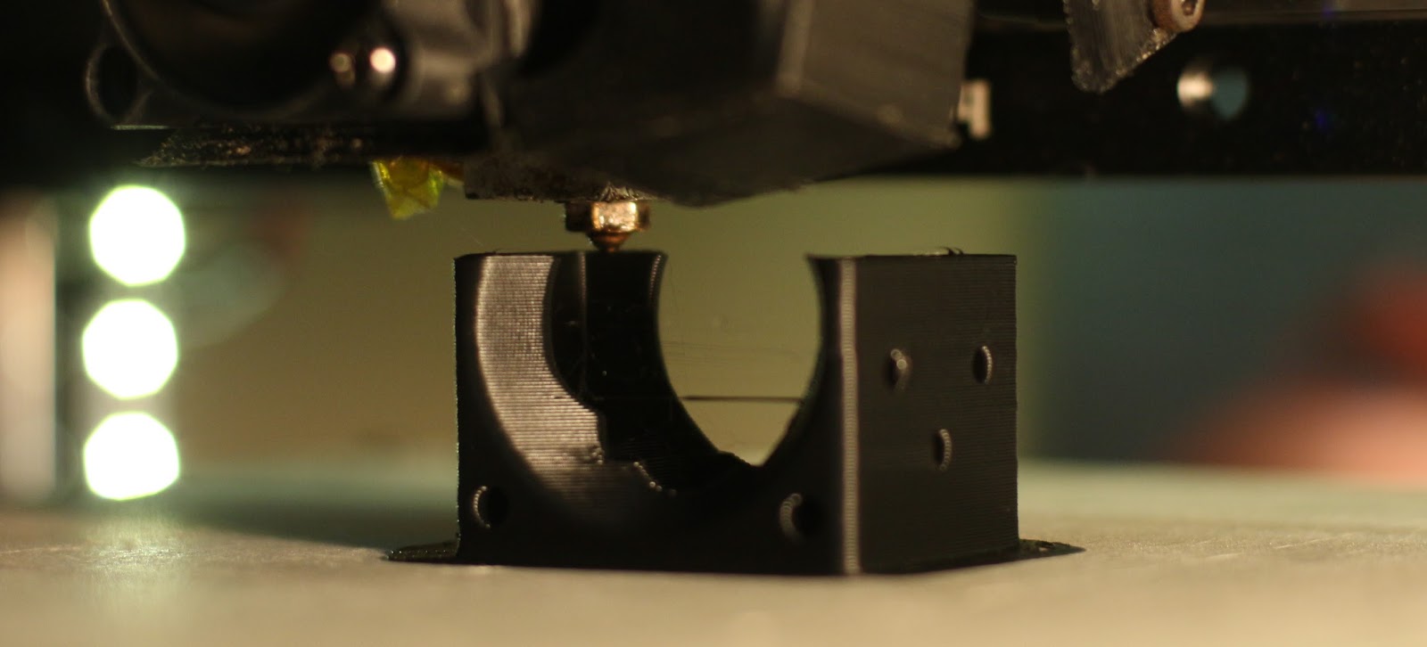

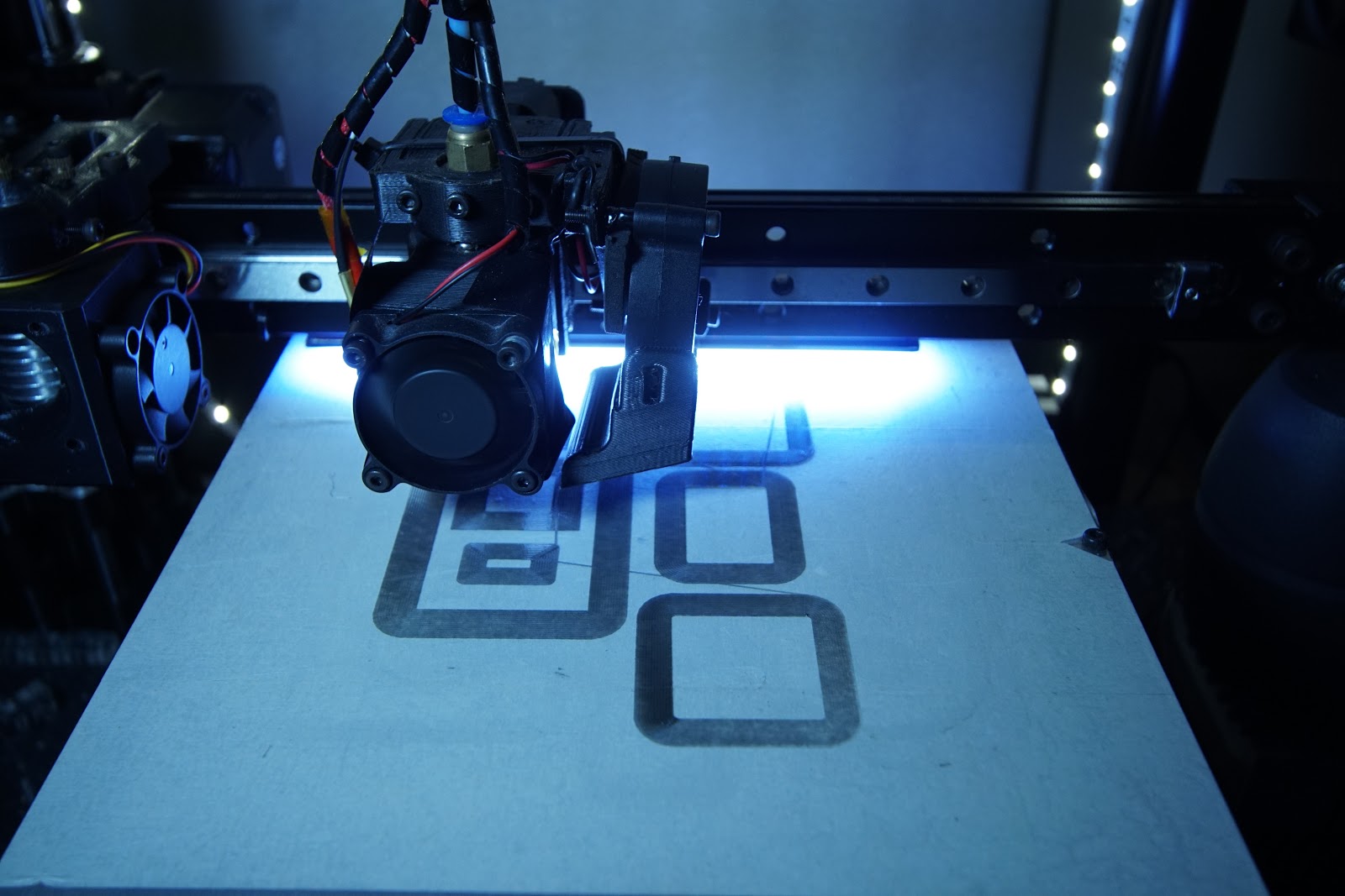

First prints with some cheap PLA, I'm on the Hunt for the Best Matte Black filament. Dont Like Shiny, Testing out a new Hotend Carriage arrangement, will probably do the camera one at some point, but before I did I thought i'd test out another idea, I should have spent a little more time on it, I was thinking of adding some metal shield(alu can) inside the cowl, but cooled from outside, just need duct to hang from front half, from the 2 spare fan holes, have about 2mm clearance, with a little room for adjustment, be good to have a lid/thin part cooler, or just blow air around rim, not sure how long it'll hold up around the hotend, but my other fan cowls doing ok.
I've run out of 40mm fans so just ordered some new Blue LED ones, and a strip of LED's for under the arm.
I was about to print a spool bobbin, that I could use for different diam' but the roll sits fine on the 35mm poles, lucky I didnt bother because it wouldnt have fitted the hole in the roll of grey I have, so In an effort to remove effort in 3D Printing the obligatory filament(so exciting) guide has just come off the production line, designed to go in the end of the 35mm tubes.
Now time to print some bigger parts...
Edited 2 time(s). Last edit at 08/30/2017 05:20PM by MechaBits.

September 02, 2017 12:01AM

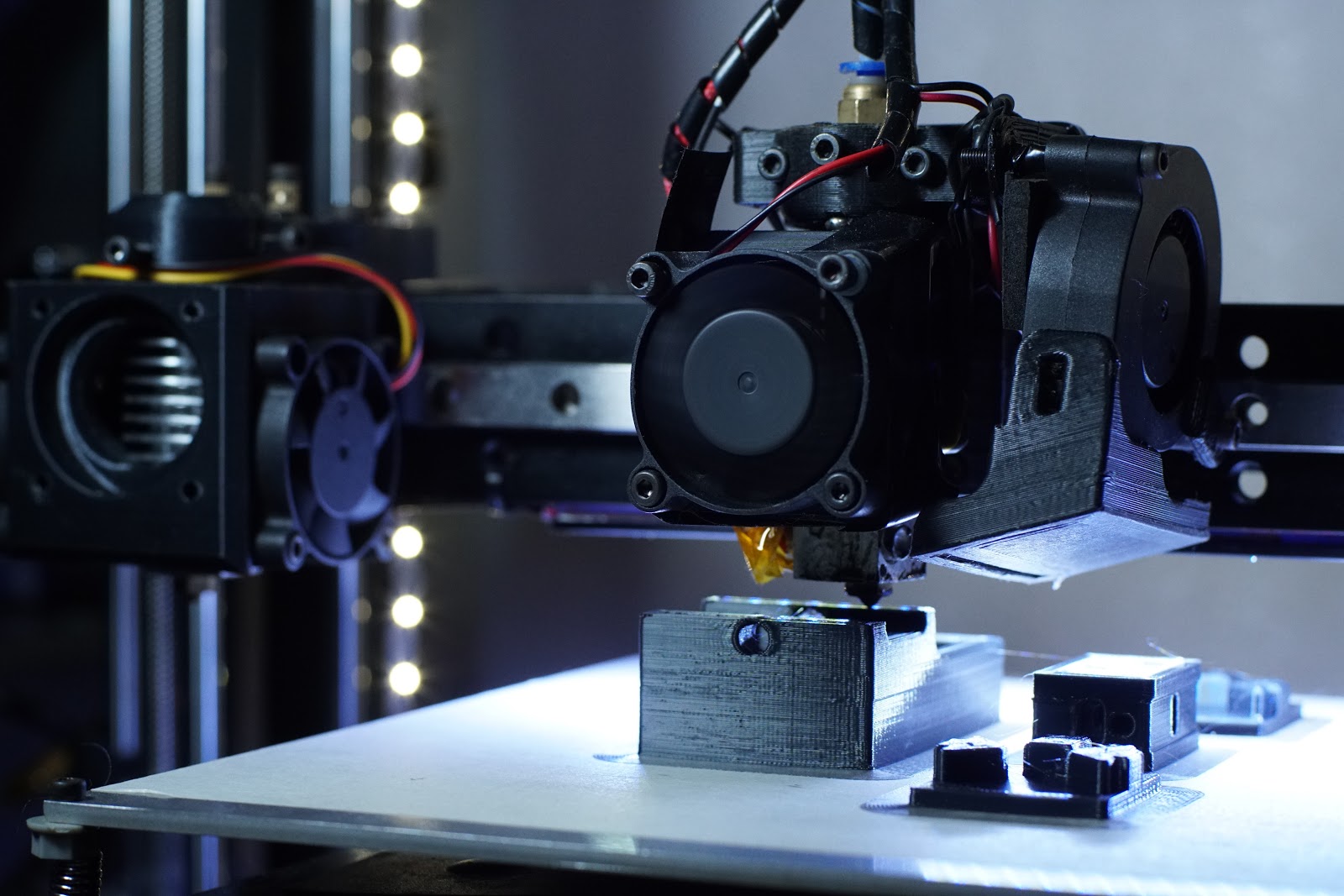

Decided to reprint the recent V6 Carriage/Cowl for the V5 hotend that's on the Printer, why change it, a black one from USA would be nice, if only I hadnt boxed it in at the front, though the Silver should look cool under the Blue neon fans, you can lift the bonnet when not using part cooling, it would be interesting to see it in clear or translucent material, but could look even cheaper than shiny black PL, (the V6 one is now bare & open as I needed the fans from it),The V5 one came out Perfect, I only hope it works as envisaged, though there are a few tweeks I could improve with, things are really close/tight I should have left more wiggle room, I should have a slightly shorter skirt/shield, and maybe a wider part cooling duct,(testing out an idea there, but these latest parts where all completed without part cooling) though i'll be testing out a longer 40mm barrel if I need to drop the nozzle a smidgen, also wondering about alt heating block maybe a volcano one (just so its taller than it is wide) , but a little worried it has no heatbreak, but I will be adding 6mm steel nuts in strategic places like the one currently running, and trying a 15mm long 40w heater to see if that helps...or redesign part cooling bit,
Edited 1 time(s). Last edit at 09/02/2017 12:10AM by MechaBits.

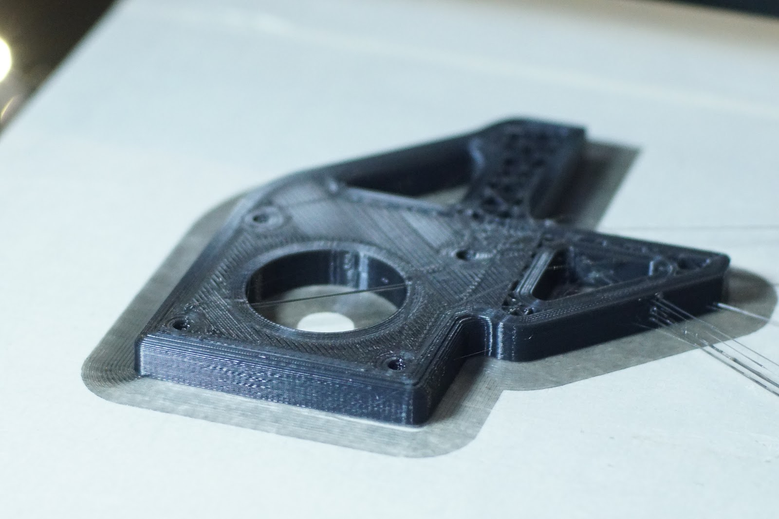

September 04, 2017 02:54AM
And another one piece version...I 'm probably going to do another, as I still think I could/should add a few other features, easier changeover would be a big improvement.

September 04, 2017 07:44AM
It looks nice, but why does it look tilted?
September 04, 2017 01:19PM
Same reason as the last one, I didnt screw it on yet, contemplating a little riser carriage with some magnets, but want to keep them far enough away from my balls, in the carriage...I have 2 link bars to go to the belt, first one warped...I used that to see if I should change the second...and for some stupid reason I thought I needed an extra 10mm length, now I dont need that...so I either use the warped one or print another with some mag mods, or some adapter block for carriage that maybe I can put a few more holes on, for some other stuff.
Though part of me wants to go back to a multipart part but just 2, and have the front half attach with magnets holding/clamping hotend to the carriage.

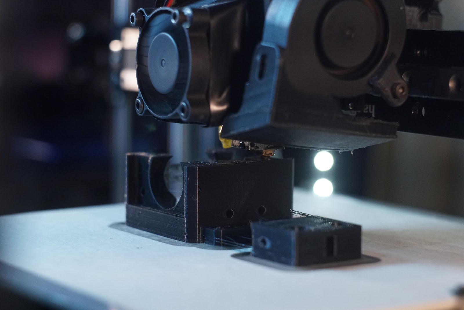

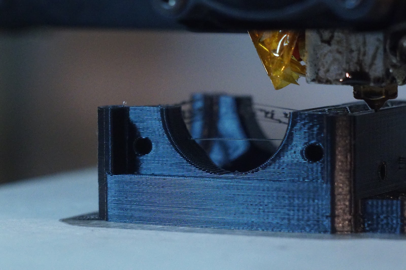

September 06, 2017 12:00AM
I screwed it... on smiling smiley and its all level, though I wont be swapping over till the blue fans arrive, the radial fan was really doing my head in, and those other nice 40mm flat ones are a little too expensive, but wouldnt mind a few at some point.
You know how it always makes sense to add another part to allow the other to cool(unless you solved the issue once & for all), but then you endup with longer waiting times for the part you really want, thats what this is, another 3030 motor mount, I thought I would reprint some of my other parts, I've got some rather large prints to come for the Z Base & Top, probably 20 or 30 hours of printing for parts I dont need right away...have to concentrate on parts I really want to use first.

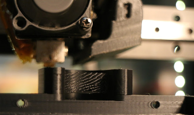

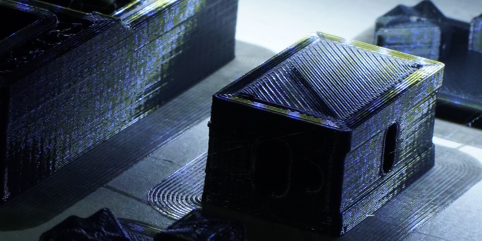

Some interesting artifacts depending on the light, but there are some dents in certain places(not the ones in this pic, some others), I'm wondering near the top where the lines go into perfect dots, wondering what the print would look like if I got that all over, I think I need to re-tighten the Y, maybe alter X a little, when I change head i'll remove the springs, and line up belt a little better, also maybe change the idler to be same size, as there is a little diagonality to the belt, might also beef up the motor mount on the arm, as it can flex a tiny amount, and also would like to support the end of the shaft so as not to stress the shaft/bearings out, then maybe i'll see a little more improvement, clamping the bed down wouldnt be a bad idea too its just sitting there at the moment.
Some of the prints earlier in the thread seemed much better, wondering if it was just the matt-ness of the other filament or changes in setup, or just lighting, will have to investigate, or find some mat black. Now need a second carriage to match first for dual setup, Back to the magnets or some other hard link.
But just before printing a carriage link i realize I dont want second head travelling all the time especcially as I have no way to stop it going over part when not in use, have to think of something else...hmmm do I really want Dual and all the Hassle?

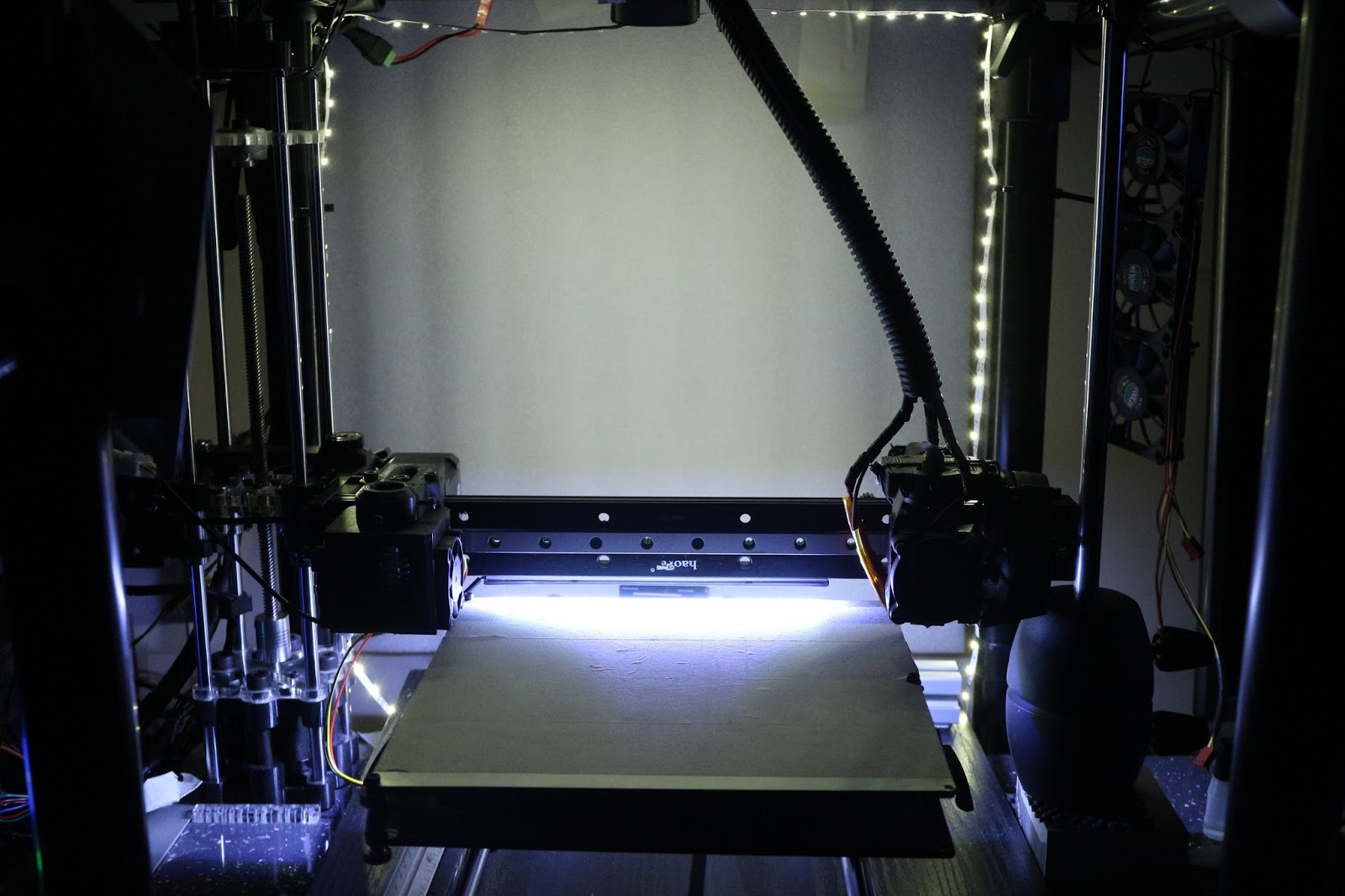

Let there be Light!
Thinking about the dual carriage needing some kind of latch rather than magnets, but must keep distance accurate.

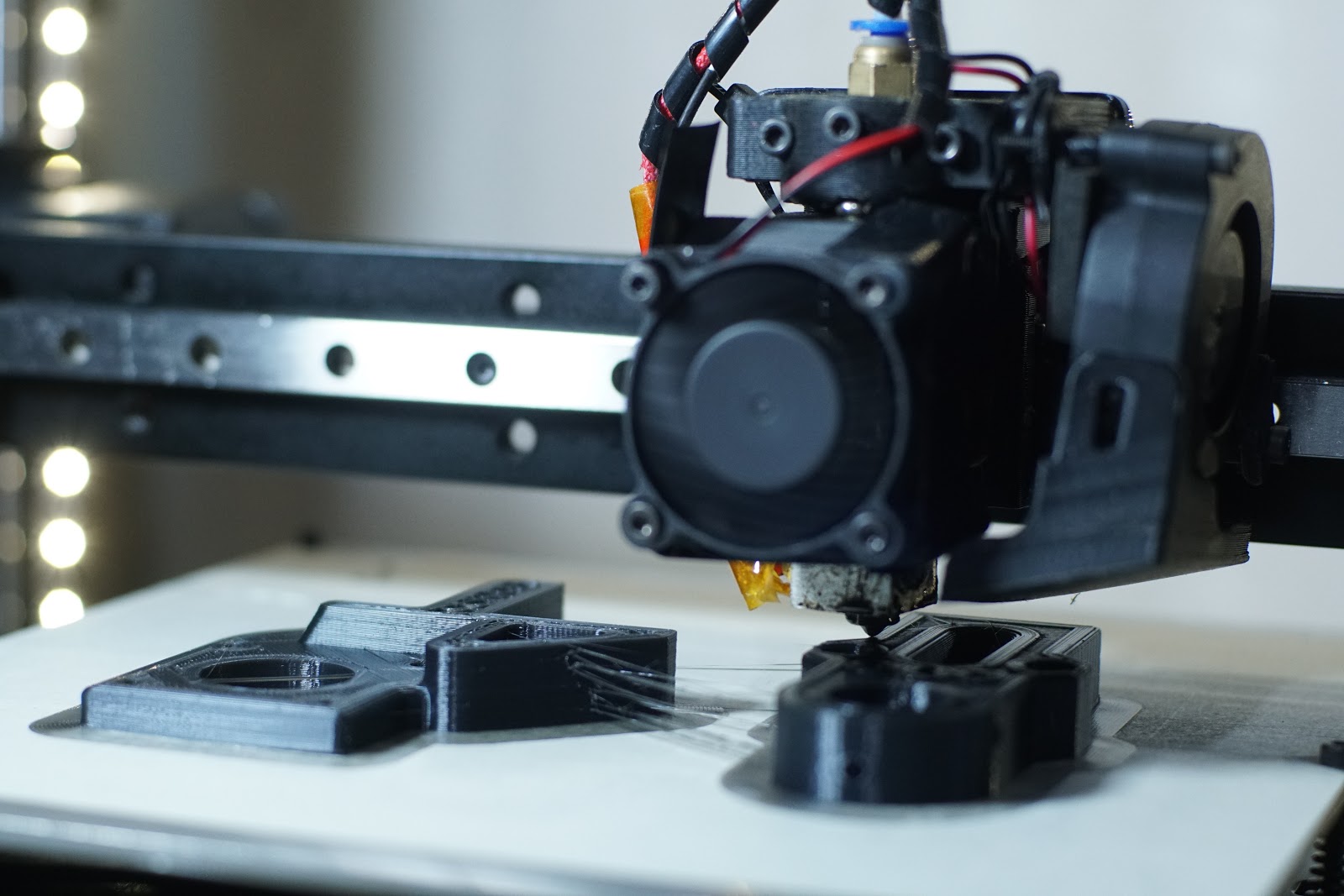

You know when your going to have an easy time & a great print when it starts off like this...
