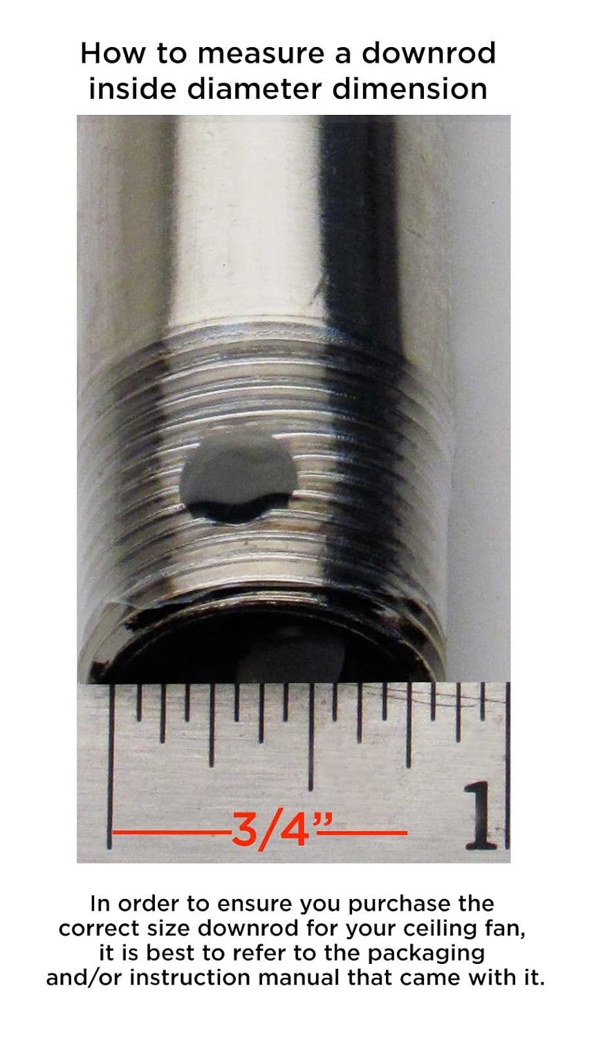

uncle_bob
I assume the idea is to more or less crush fit the bearings on the pipe (17 mm bearing ID and 17.14 mm pipe OD)
uncle_bob
what's a good cheap / easy bearing for the 1/4 IP stuff at 0.540" (13.716 mm) ? R10 or 1633 maybe?
