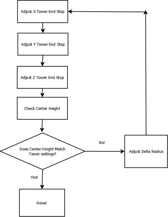

The distances between the towers measure within 1mm from each other, the heights are as well, the rods are identical by way of assembly.Quote
A2
Deltas require symmetry, parallelism, and squareness.
Error of movement comes from these deviating from being perfect, (assuming your software variables are not mucked up).

At first i could see the carets stopping in different positions - about 0.25mm off - depending on direction.Quote
hercek
How did you find out what location did the head come to?
Did you use M114 (Get Current Position) command?

Cause it's quite small - 14 cm centre to tower rails, with extruder location at 7 cm towards tower, the horizontal distance covered by the 18.5 cm rod is (7 cm - 3.3 cm for platform -2.2 cm for carriage) = 1.5cm, almost vertical.Quote
hercek
How could be rod almost vertical when the head is half way to the tower?
Maybe.Quote
hercek
My guess would be that belts somehow needed to settle to the puleys or maybe ball joints needed to settle somehow

DELTA_SMOOTH_ROD_OFFSET is the horizontal offset from middle of printer to smooth rod center. I don't own a delta (yet) so I'm just going by what the wiki page says.Quote
reprap wiki
If your print head is too high or low in the middle of the print surface, adjust DELTA_SMOOTH_ROD_OFFSET by half mm and try again.
