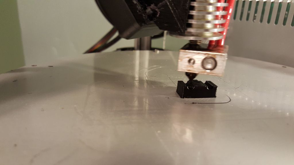

Re: Folger Tech Kossel Delta 2020 Full 3D Printer Kit w/Auto-Level
July 15, 2015 05:27AM
Finally got it! Think I'm the bed is pretty level now. Now to fix why my hot end seeps ever so slightly. Hey to all of you, what do you use or do to clean your. Pieces when they are done? Dremel? Xacto knife? Thevisad thanks for the guide once I deciphered enough my print head is moving level like a charm. Thanks to all again, this is so cool to see it go
July 15, 2015 11:55AM
When you assemble your hotend, it helps to do it the way E3D (which the Folger is a clone of) specifies. Screw the nozzle in all the way, and then back out 1/2 to 3/4 turn. Screw in the heat break until it is firmly against the nozzle (but don't tighten yet). Add the heat sink, which should go on until it bottoms, all leaving a gap between the heater block and heat sink. Now, bring the whole thing up to 245C or so, and only then tighten the nozzle until snug against the heat break (they define snug as one fingers pressure on the end of the wrench - no merit ingoing gorilla on it). The primary seal in the hot end is the nozzle against the end of the heat break, *NOT* the threads, and if this is snug, the tolerance of the threads really doesn't matter much . . . And be sure that you don't get the heat break in upside down . . . mine had no cut-down section, so I had to determine that the top was the end with the taper. Having done this, I never had even the slightest ooze with the Folger hot end, and only one jam (but that was due to an extruder failure). What you *WILL* find on this printer is that while the extruder works OK, it eats the grooved bearing rather quickly, so either get some spares, or consider printing/buying a new extruder.
Or, did I misread and write all this, and you are actually talking about ooze? :-) :-)
Oh, and to date, I find that I can do what cleaning I need to do with an X-Acto knife, but that can't be the only way.
- Tim
July 15, 2015 12:09PM
tadawson
- Tim
Exactly what I was looking for. I'm going to probably get a new hot end since this one is probably full of plastic now and follow your exact advice. It's not much but enough that once in a while it leaves it behind looking ugly on one of my prints. I guess the exacto knife is the best solution seems like.
Thanks Tim.

You can heat them up and the plastic pretty much just falls away with a bristle brush or soak it in an agent and it will dissolve away. At most you might need to replace your throat, but if you do get a new one, you might consider getting a real E3D and not one of the knock offs. http://e3d-online.com/E3D-v6/Full-Kit
July 15, 2015 01:09PM
Or, if you want to try to save money, the threads are the same, and you could likely use a real E3D nozzle with the other Folger parts. As thevisad said, getting the crud out of the hot end really isn't that bad . . .
- Tim
July 16, 2015 12:24PM
Ok. So I bought a new nozzle and change it and it still seeps out from the nozzle and from the heater block. What Settings do you guys use for extrusion and extrusion speed on pronterface? Mine ar set at 30mm at 300mm/min speed. Is that way to off?
