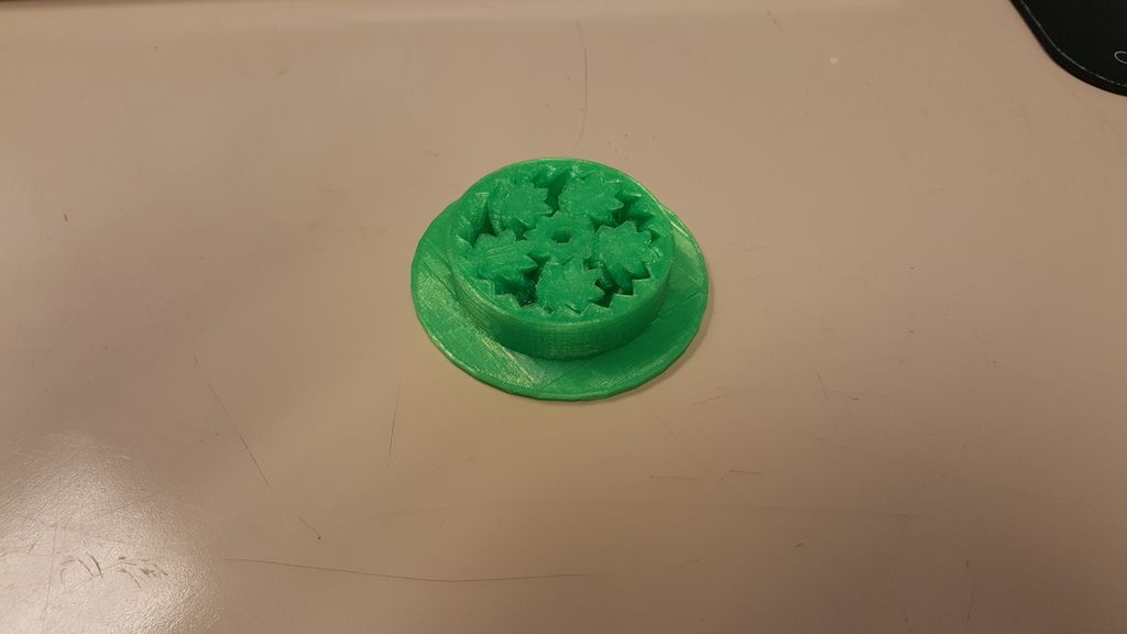

Thanks for all the tips. Broke my spool holder that came with the Kossel and decided to try making this one. Bearing works awesome. Do most of you keep the same type of Filament holders? Or do you have some new ones printed.
Another question is whats the nozzle size of preference most use?

Re: Folger Tech Kossel Delta 2020 Full 3D Printer Kit w/Auto-Level
July 18, 2015 10:03PM
Thanks for the link - i am in the midst of printing the bearing now - the last time i tried with the .3 tolerance it welded together.. :/ so i upped it to .4
Really shows that i have to work harder at calibration! that's a slick looking spool holder for sure!

Whats the general rule with nozzle sizes? The bigger the more fine detail and faster prints? I have some .4, and .5 to try aside from the .3 that came with the printer.
July 18, 2015 11:14PM
I printed a modified pair of those bearings to fit on the arm that comes from Folger, and that has been working great for me.

Stick one gear bearing in each side of the spool, slide the assembly over the inner section of the plexi arm, and keep it from walking off with a binder clip. I used customizer to make the bearings with a center gear with a hole sized to fit the arm . . . and I can't say that I have had any issues feeling that the mount it weak . . . I just added the bearings because it wasn't feeding smoothly on the sharp edges of the plexi.
I found an end stop mount made specifically for the end stops in the kit. Again, not replacing for any strength issue, but rather that they didn't sit flat.
Perhaps you are tightening your hardware too much? This is M3, and doesn't take much . . . I've been running close to two months, and the plexi looks the same as the day I got it. My printed corners are deforming from heat, but that's a different issue . . .
