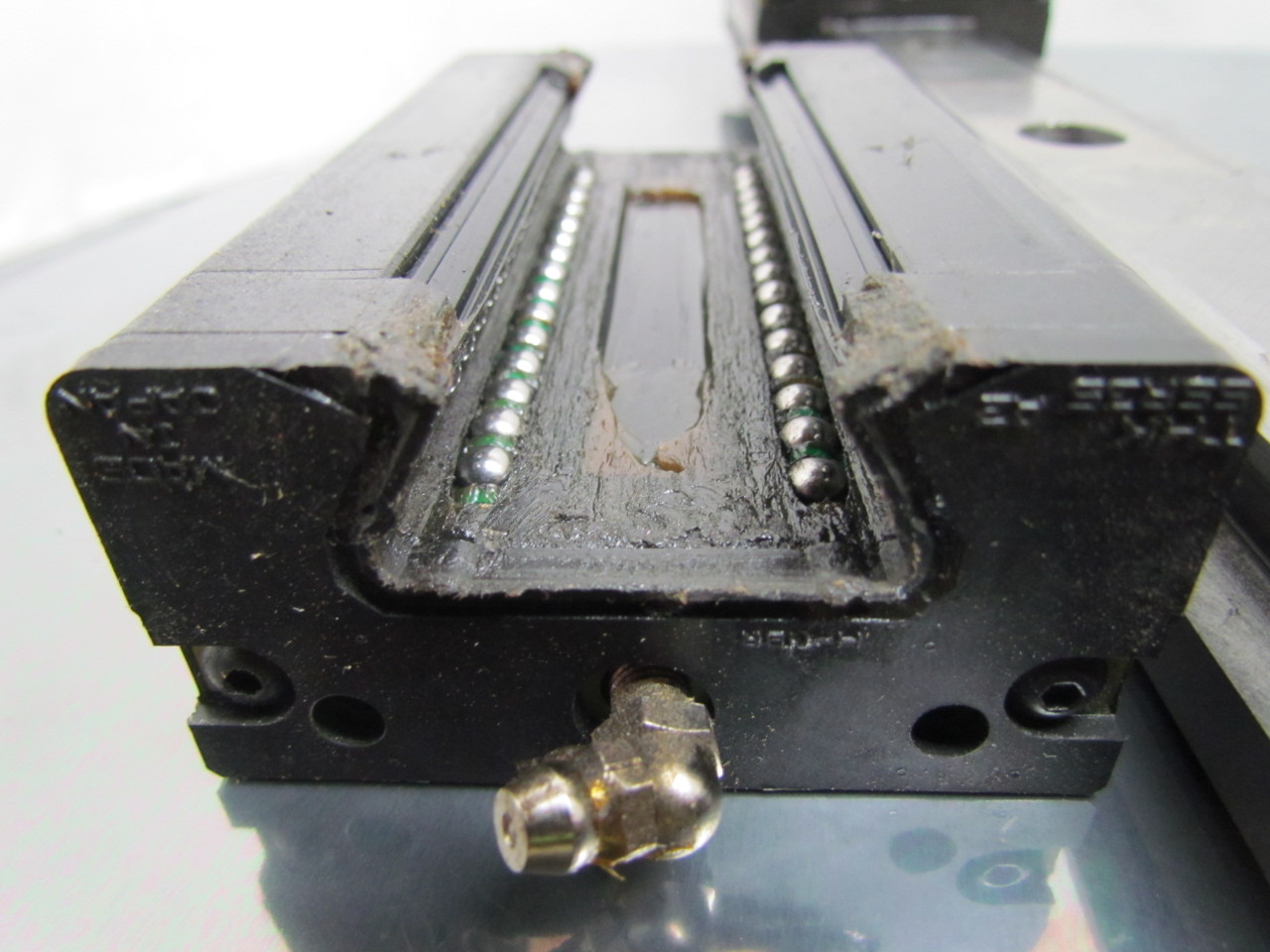

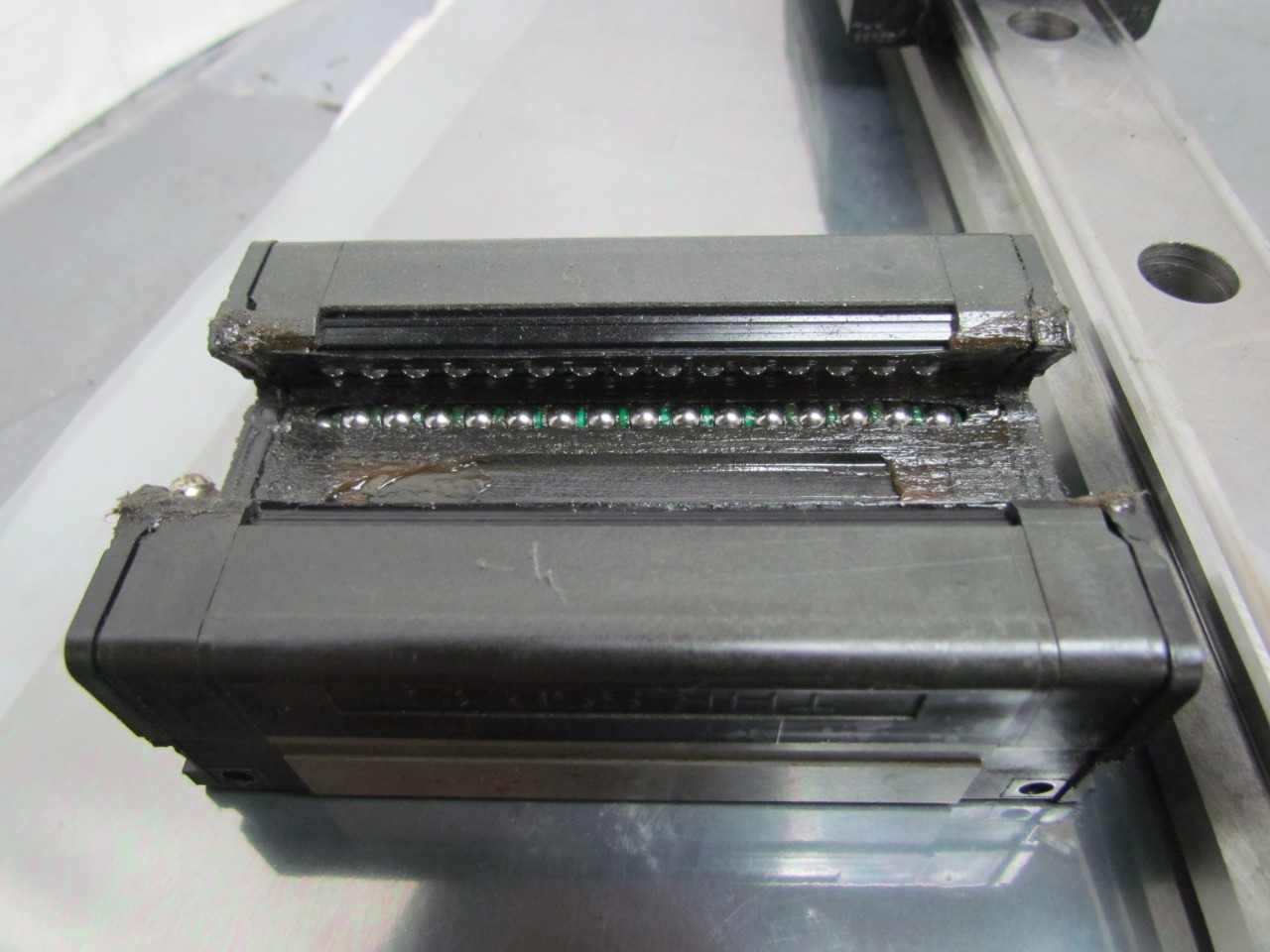

wrangellboy
I think I've narrowed it down to one of my linear rails sucking. One of the three has always been worse and I think that's the root cause. I think it was causing my stepper on that tower to overheat and skip steps. I've finished a couple 1/2 hour or so prints now by turning down the speed and putting a bag of ice on that stepper.
Folgertech warns against taking the sliders off the rails, how hard is it to take them off and check/clean/repack the bearings? I've ordered new bearings (as well as stepper motors with about 2x the torque...), but due to the warning, I'm a bit nervous about taking them apart.

tadawson
Ultimately, I just lubed the snot out of my rails, and flushed with enough lube tomrinse the swarf out. When I stopped getting black gunk, things were pretty good . . . no idea on ball count, since, due to the length of the carriages, first I'm not certain it matters much, and second, having the clearance of one ball makes sense to me to avoid binding, so claims of 'all are missing one ball' I read as 'one ball clearance is correct and as per design' . . . the issuenis lack of slop on the rail, not will it drop 1/4" by itself . . .
- Tim
