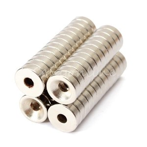

So I'm in the process of getting my delta printer (MOST delta style: [www.appropedia.org]).
Unfortunately, I seem to have quite a lot of problems with the magnetic joint system. The build uses ∅10x3mm counter sunk ring magnets (N50 strength) on the effector/carriage and steel balls on the rods.
During movements (either while printing or when running a calibration) the rods often drop out of their hinges and the effector dangles free, destroying the process of anything done.
I checked the strength of the magnets and it seems there is a big difference in magnet strength. For example, on some magnets I can pull the carriage with a single rod up and down, with other magnets the rod pulls loose immediately.
For now I try to get some dirty hacks running so i can print new carriages and an end effector with another system. As I have so many problems with my joints now I feel a bit reluctant to use the same system again.
What is your experience with magnetic joints? Was it just bad luck with weak magnets, or is the whole system inherently flawed? One thing I think I would add is hinges on both carriage and effector so I can secure them with a threat or fishing line.

The method in favor this week is strings/springs to hold tension on the rods, and not even using magnetic parts. This would certainly help to hold your current parts together as well. Check out the Cherry Pi IIIs on Thingiverse for an example.....

I was having the same problem and i figured out was friction between the magnets and ball bearings making the pop off i just put some oil on the magnets and it fixed the problem.

Others have solved this with small felt circles, or more complex systems used print parts as the friction surfaces and keep the magnets at exactly a minute gap. Look up Haydn Huntley's magnetic rods ends on Google for a great example.

Oiling the magnets didn't work for me unfortunately. For now I just doubled up the ring magnets on the carriage which seems to work enough for slower speeds.
The design of the Cherry Pi IIIs was the one that gave me the idea of using the fishing line and hinges to secure carriage and effector. I already have the rods with steel balls on each end, so I might give it a try.
But maybe a pure magnetic system should work enough if you use big enough magnets. Haydn huntley's rods use a 15mm zylindrical magnet. I have a 10mm at home and the holding force is just immense.

Matthias, if your magnets are all the same (field strength/size/etc) then they should have the same performance. It sounds like you bought a few duds. Perhaps buying a new set of magnets to replace your duds is your best solution. If you'd like to swear off magnets completely, vreihen seems to be on the right track with strings or springs.
However, I think you're touching on two much larger inherent flaws with magnets:
1. The strength of the magnetic field decreases rapidly the farther away you get from the center of the magnetic array (in both the radial and normal directions). A displacement of even a few mm's between the two parts will greatly reduce the attraction force. There's also no warning or signs a failure is about to occur, the connection will just completely fail. This is obviously undesirable (as you saw) because you will squish your prints. You could design some sort of system to prevent the failure from catastrophically destroying your prints, but at that point I'd just switch to something mechanical or chemical (strings/springs/zipties/glue) as it seems like a lot less work.
2. There's no way to "fix" or "adjust" a ring/bar magnet unlike other components. What you see is what you get. If the magnet is weak/broken/etc then there is nothing you can do to fix it.

I had problems for a long time where the hot end would hit a curled edge on a 13" wide print and pop a joint off. This limited the width I could print reliably.
I ended up adding two springs between each set of rods: between the bearing cars and the effector.
I attached eye-bolts top and bottom and used stainless wire to connect them with the springs.
I used calipers to make sure I sprung the springs the same amount. This eliminated the problem.

3) Rare earth magnets permanently lose their magnetism when exposed to heat in the range that one would encounter in a heated build chamber.
I went seriously overboard with the springs on my latest build:
I haven't actually printed with it yet, but it did go through multiple auto-calibration runs without losing a rod.....

Many rare earth magnets do loose magnetism (even permanently) at higher temperatures in the range that would be used here, however there are some that do not.

I have had good luck with N52 countersunk magnets and 10mm ball bearing. The only time the effector has popped off is if the head crashes into something.

So I switched to a system with fixed ball bearings and magnets on the rods. I used Geomag magnets for the rods (I got inspired from this design), which are not the strongest, but it seems to be enough. Modifying The effector and carriages was quite simple, I simply glued the balls to the ring magnets (Maybe I will print another set of parts, but for now it's ok).
I'm not sure, but it feels like having the magnets on the rods has a stronger connection, especially when exposed to shearing forces.
