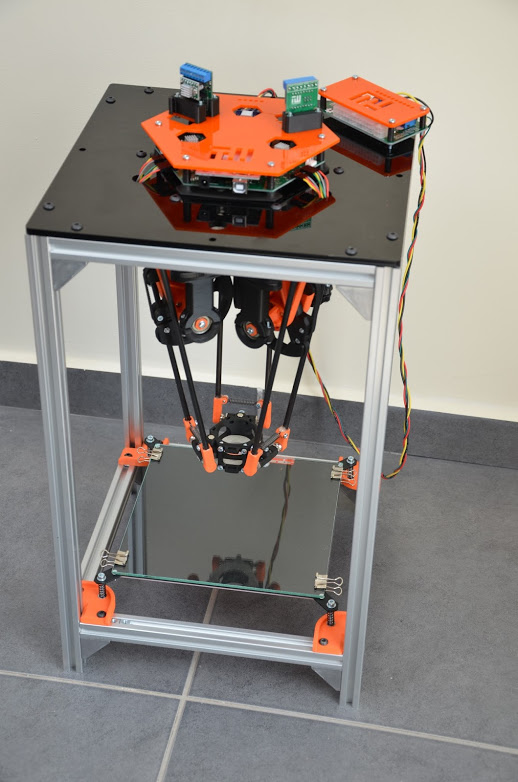

Hi, I am a fan since the begining of the firepick-delta for it's way to avoid linear rods. Now after a few years I've checked back if anyone has built one and can't find anything. I am posting this in delta forum so you,the delta gurus, can tell me your opinion.
Is, as of now, the firepick delta a good option for a delta printer? On their webpage it mentions Marlin for compatible software so it could be built to only take advantage of the 3d printer for now and maybe adapted later for the pick-and-place stuff.

o_lampe
The frame's stiffness is very important for this setup.
Four vertical/ parallel extrusions are not the stiffest platform.
If these guys had guts, they´d build the frame like a pyramid...

ekaggrat
somebody built a similar machine but said he had a lot of calibration issues.

TTN
If you make a solid frame, 0.9 degree steppers, a 32 bit controller, and use very carefully measured parts and and accurate assembly, I think you could make it work.
, with that list you can get cheaper with cartesian.|

lutz_dd
@TTN ... any detailed information regarding the 4% deviation along the z-axis would be really interesting especially the strategy to backtrack measured deviations to the root cause.
FYI my frustrating setup ... arms are directly mounted on the stepper motor shaft 0.9deg, 16 microstep, about 40gr weight endeffector just for PnP SMD 0402, all 3 motor motor are mounted on a single printed piece of PLA, 90mm upper arm, 236mm lower arm ... step resolution in the near of 100um ... accuracy error 2500umat worst corner of an 80x80mm square with z=70mm from zero reference (upper arms horizontal)
