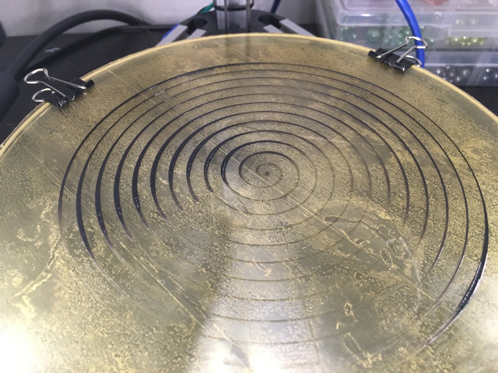

Kossel Mini bed leveling problem December 14, 2015 04:22PM |
Registered: 9 years ago Posts: 59 |
22:10:45 CET M666 Endstop adjustments X1.28 Y0.45 Z-1.73 22:10:43 CET M665 Diagonal 215.00, delta radius 105.11, homed height 241.53, bed radius 85.0, X 0.49°, Y 1.19°, Z 0.00° 22:10:35 CET G32 Calibrated 6 factors using 10 points, deviation before 0.163 after 0.113 22:09:48 CET M666 Endstop adjustments X1.41 Y0.12 Z-1.53 22:09:47 CET M665 Diagonal 215.00, delta radius 105.12, homed height 241.59, bed radius 85.0, X -0.56°, Y 0.48°, Z 0.00° 22:09:42 CET G32 Calibrated 6 factors using 10 points, deviation before 0.172 after 0.135 22:08:53 CET M666 Endstop adjustments X1.18 Y0.44 Z-1.61 22:08:52 CET M665 Diagonal 215.00, delta radius 105.01, homed height 241.57, bed radius 85.0, X 0.32°, Y 1.14°, Z 0.00° 22:08:34 CET G32 Calibrated 6 factors using 10 points, deviation before 0.350 after 0.088

jschenck
I first noticed that indeed the bearing spacing at the carriages was approx. 0.4mm less than the bearing spacing on the effector (strange, because all parts came from the same vendor). However, as this was the same over all three rod pairs, I suppose this can't be the problem.

tomasf
Ooh. That makes sense. Shoot, I wish I had read that before. Oh well, I'm off to get some heat-resistant paint and hope there's enough adhesive tape left on the roll so I don't have to order another one from half-way across the planet.
Thanks again!
