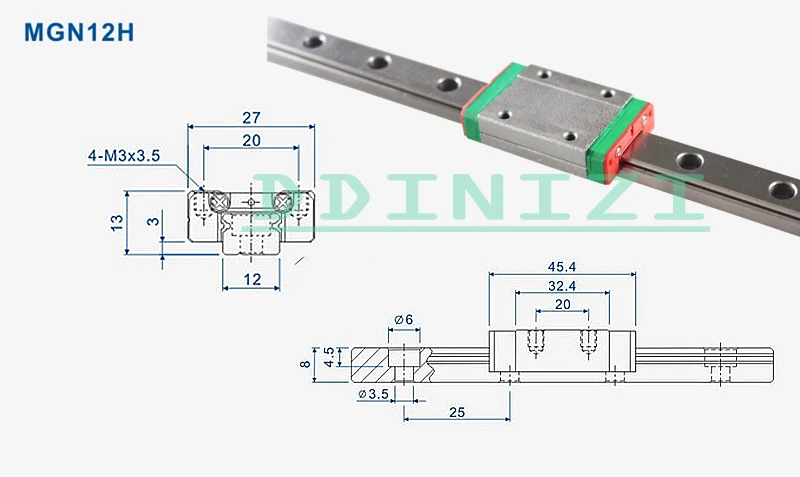

Greetings!
I have some 600mm Misumi 1515 Aluminum extrusion for my delta. I just ordered 500mm MGN12H Linear rails. I am not sure what length bolt and what size T-nut to order to mount the linear rail?
Any advice!
Thanks
Max
Re: Ordering parts need advice regarding linear rail
February 24, 2021 04:41PM
Those look like the same rails on an Anycubic Kossel Linear Plus. The manual [gzhls.at] on page 6 says to use M3 8mm bolts. I'm not sure about the T-nut though. Hope that helps.
February 25, 2021 03:50AM
I made "tnuts" for mine by drilling and tapping M3 holes in .5"x.125" rectangular aluminum bar. I used 2550 extrusions. 1515 is way too small unless you add stiffening brackets.
February 25, 2021 08:39AM
They make T-nuts for 1515, but I needed to know what size to order. I have 6 sticks of 1515 (600mm).
Maybe you haven't used it before, but it is 100% rigid. You are not bending this stiff. Plus, I'm adding the 12mm linear rail which is steel.
I believe initially they used M3 with square nuts. But I can see the benefit of T-nuts
