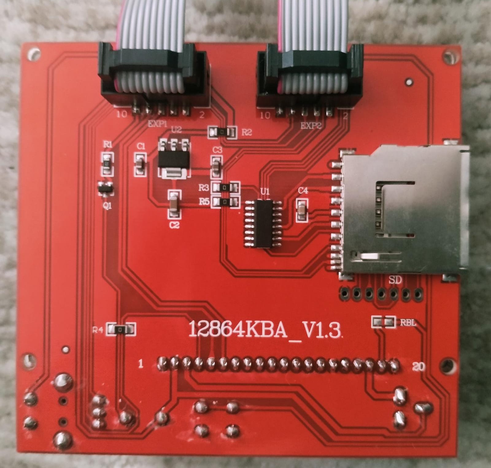

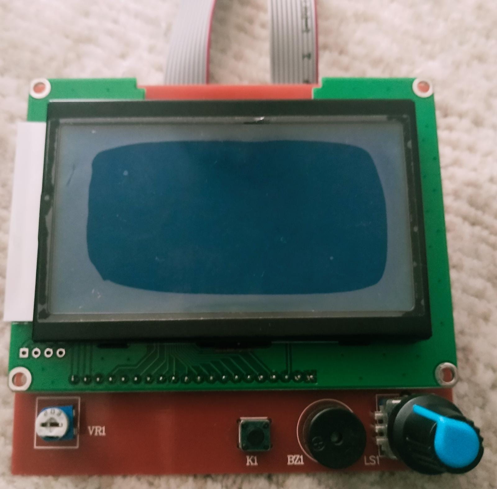

bkarpuz
I have placed RAMPS 1.6 on my Arduino Mega Clone. When I feed RAMPS 1.6 with 12V 2A, the AMS 1117 component on Mega is getting hot. I might have attached fans to D9 and D10 in the wrong direction and gave it a try for a second. For testing, I have placed Adafruit Motor Shield on my Arduino Mega Clone and fed it with 12V 2A, the AMS 1117 component did not get hot.
Does this show that something is wrong with my RAMPS 1.6?
What do you think can be the problem?
I have a multimeter, which components should I test for discovering the damaged component?
Thank you.

Dust
The display get power form exp1 and should light up when plugged into exp1
you don't even need exp2 for the lcd display itself to work. (you can leave exp2 unplugged and the display will light up and display things, but the encoder will not work)
Exp2 is used for the encoder left and right, the kill pin and IO required for the sdcard.

VDX
... could be a "semi-short" somewhere or something is oszillating wildly.
Check for shorts or low resistance especially at the endstops.
Best methode for checking external loads is with unplugging them and mesuring the drawn current ... caution with th estepper drivers! - they could burn when plugging/unplugging the motors when powered.
