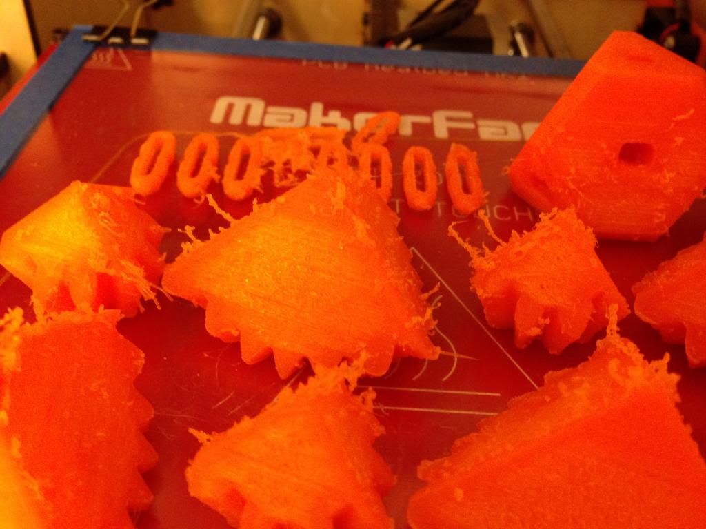

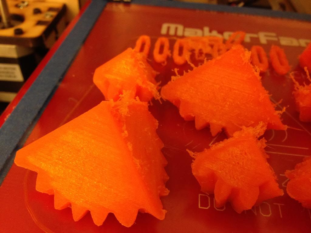

1.2mm sounds reasonable unless you have a bowden setup, but are you sure your extruder is capable of retracting at 60mm/s? If you retract too fast, it might not retract at all.
