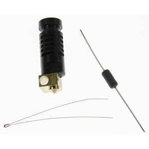

Currently using a
3D Printer J Head Hot End Kit for 3.0 mm Filament - 0.35 mm, Resistor, Thermistor, Teflon Tubing (from Amazon)
But I have also ordered a
Getech 3D Printer RepRap Assembled J-Head Hot End Hotend for 3mm filament ABS/PLA for Prusa Mendel. 4 options Nozzle Size:0.3mm,0.35mm,0.4mm,0.5mm (0.3mm Nozzle) (also from Amazon)
Which I am waiting to arrive, as I think I might have messed the original hot end up, since it keeps clogging up

It's possible that the J Head that you have is a cheap clone rather than an original J Head. Can you link to the Amazon product that you purchased? Can you also post a picture of the hot end you have, so we can see if it matches what you ordered?
TheBearF8
This is definitely a cheap J Head clone, and will likely have problems with printing anything other than ABS. See: [jheadnozzle.blogspot.com]

Sure the original J-Head
[www.amazon.com]
[ecx.images-amazon.com]
Following you jheadnozzle link very much like the first one including the red inside tube , washer and hex nut etc…
The RPW MK V-BV hotends.com
Can you then recommend a link where I can buy a decent Hot End that will print different materials esp. ABS, PLA, Nylon and NinjaFlex

They are selling that hot end as an original hotends.com hot end, so the hot end you received should match that image exactly (5 slots in the PEEK, compact brass heater block/nozzle, red PTFE liner, etc.).
TheBearF8
The original hot end that you got should have no problems printing all of those materials if you use the proper temperatures, though printing nylon will bring temperatures close to the max operating temperature of the hot end (this is true of any hot end that uses PEEK and PTFE). Do you have a fan cooling the PEEK for printing PLA? Without it, PLA will usually jam.

I'm attaching two photos
( 0892 )
The first is the original hot end I just pulled it out of the holder
Yes I have a 12VDC fan blowing on the PEEK (The black tube) yes
The Other hot end I was waiting for just arrived and so I photographed it ( 0893 )
The only print I have managed to get right was PLA without the fan at around 205 oC
Everything else has failed, including the latest attempts with PLA using a fan

In this case, I would try getting an exchange on the original hot end you purchased. With a fan blowing on the PEEK, it should have no problem printing PLA.
That new hot end you bought may work, but I wouldn't be surprised if it fails to print anything other than ABS.
