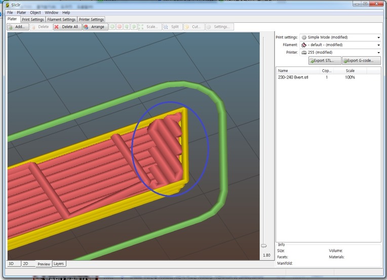

I wanna remove infill in blue circle at image.
Where is the selection or control menu?

It's the gap fill
speed
. Set it to 0 to disable gap infill.
