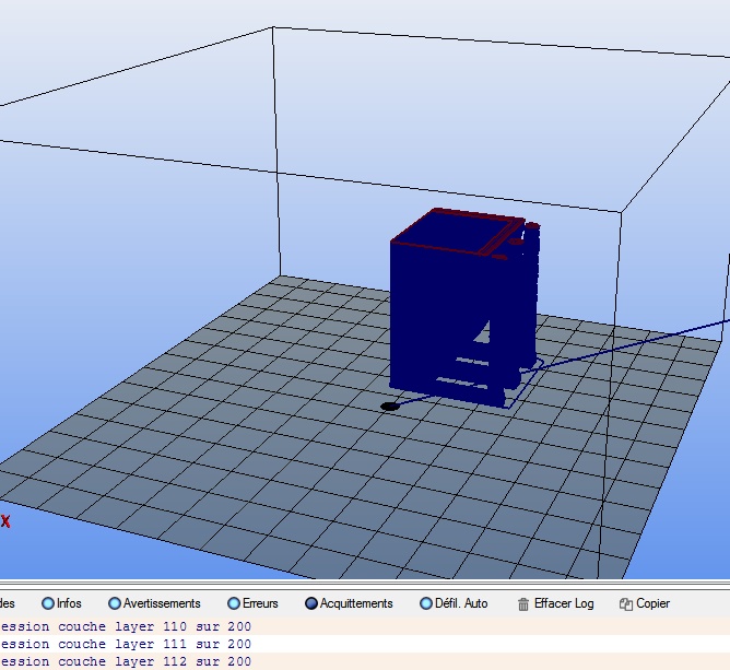

Hello, i recently switch to repetier firmware + host for my huxley, it's great software !
Altought i got a "minor" bug in the filament 3d view.
it show only a quarter of what is really printed and show some strange line from an unknow origin.
example :
I was printing the shovel of excavator
I use the latest buil on a windows seven x86
I also have a minor bug with slicing with skeinforge47 and peepee : the multiply script doesn't work but i think it's because of peepee and i can bypass this by multipling in repetier, so no need to correct.
Re: Repetier-Host 0.90 beta windows Feedback wanted
June 10, 2014 02:57AM
Ignore that line. It is the first line from an unknown position outside.
Looks like you mean in the print preview it is only a quarter. From the filament type (simple) I guess it was already reduced cause of slow frame rates (FPS xxx right to progress bar). There should also be a message about this in the log. That is only a protection to continue your print, if the update rate gets too slow. If update rate goes low your communication get hangs which you do not want. So better not to show everything and have a good print. Make sure you have selected autodetect in drawing method in 3d visualization.

indeed the frame rate is low (typically ~10fps) and i've got the emssage about reducing quality.
I use and old laptop with a Turion 64 @2.1ghz and an integrated X200 graphic, i will try with another more up-2-date computer.
Thank for the explanation, my guess was that the reducing quality was only about quality and not quantity.
