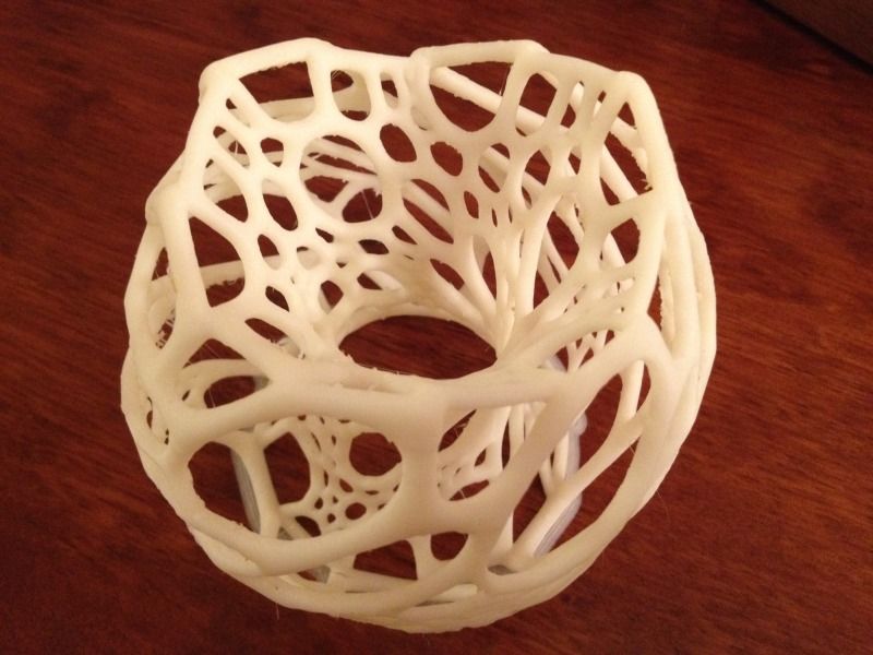

Edit 2: Here is a crappy photo of my print, I will try to get a better one up later.
This was printed using Slic3r and the following settings:
; layer_height = 0.2
; perimeters = 2
; solid_layers = 4
; fill_density = 0
; perimeter_speed = 50
; infill_speed = 50
; travel_speed = 130
; scale = 1
; nozzle_diameter = 0.35
; filament_diameter = 2.9
; extrusion_multiplier = 1
; single wall width = 0.49mm
; first layer single wall width = 0.60mm
Total actual print time was 3 hours, 57 minutes, 52 seconds. Using Diamond Age kiwi green PLA and a 0.4 mm J-Head hotend.

Here's my take of it. It's not the best of quality as I was hoping to be but at least it didn't fail. There was one section where the bridging was failing, causing it to blob all over the place and I was debating to bail on the print. Although, after a few layers, it seemed to correct itself and I figured I just touch it up later with some sanding and acetone welding/smoothing. Going back to fine tune my bridging calibration.
Slic3r Settings:
; layer_height = .2
; perimeters = 3
; solid_layers = 3
; fill_density = 0
; perimeter_speed = 35
; infill_speed = 40
; scale = 1
; nozzle_diameter = 0.25
; filament_diameter = 2.73
; single wall width = 0.26mm
Machine: Printrbot LC+
Print time:6 hours, 39 minutes
Material: Makerbot's Natural ABS
Hotend: Ubis Hot End
Edited 1 time(s). Last edit at 09/03/2012 02:52PM by gyronictonic.

I've tried three times so far and had three failures.
The first two got knocked loose, the third one stayed stuck on the bed but suffered a massive shift in the X axis, presumably when the nozzle was obstructed by one of the bridges as it curled up.
I might give it another go but any suggestions for tweaks to the gcode would be gratefully received.

If you are printing PLA you will most likely need a fan blowing over the print to stop the curling. I use a PVA solution on my heated bed, which makes everything stick really well.

@richgain - I'm having almost exactly the same results, first two times, looks identical to your pictures. (Nice Brown PLA BTW)
I pumped up the BRIM to 2.6mm and added PVA solution and the third is sticking, but I can see I'm printing way too fast (80mm/sec and 260mm travel speed) and trying to do it without an external fan with PLA is not going very well.
And the X axis has just skipped on the last 5mm of the print! damn. it was just about acceptable until that. I'll let it finish.
It's finished now 3Hours 6mins, I think it needs to be 5+ hours for a decent print.
I'm using some concentric infill, maybe that's not a good idea after all.
Anyone know how to make Slic3r 0.9.1 do each island completely then move on, on older versions you just set Perimeters to 10+ and that did it. With V0.9.1 it jumps around all over the place for each section in the layer, my fast travel moves are crashing into each island...
At 0.3mm layer height my Gcode is over 17MB, that's not a good sign.
This is a tricky one...
I'll try to post a picture and have another go, slower, with lift on the Z axis and maybe an external fan, or two... or three...

I tried to print it several times also richrap 4th time was the charm for me. I used three loops with zero infill.
The best advice is to use Kisslicer, I have used several versions of Slic3r and since switching never looked back, it handles everything much better. I am still using the free version after several months and a couple pounds of PLA, and some ABS and PC and hands down the best slicer out there.

It printed just fine for me the first time using Slic3r, no brim. Total print time was close to 4 hours. I do have two 40 mm fans blowing over the hotend and print though, which helps with the curling problem.

@newperfection - I'm using my new ducted fan on full power but even that didn't seem to stop the bridges from curling up.
@gulf - I tried Kisslicer a while back and liked the look of it but the output seemed incompatible with Repetier Host, which I use for all my printing now. I might go back and give it another try to see if that's been sorted out.
@richrap - glad it's not just me. Perhaps printing more slowly would help me too.

Not going to lie, I really struggled with the overhangs on this one. I printed it on a prototype of an as yet unnamed new machine a friend and I are working on. But here is my stab at it, print is straight off the machine:
My slic3r settings for ABS, printed with a fan @230degrees. I had a lift turned on between travel moves to prevent the problems of nozzle collisions Richgain is having (I didn't try it without)

Re: Cellular Lamp / Week of Aug 28 to Sept 10 2012
September 08, 2012 04:37AM
Here is my attempt. Filament decided to jam at the last 10% or so, but it's mostly finished.
Struggling a little with big overhangs, might be a symptom of using a large nozzle with a small layer height.
; layer_height = 0.15
; perimeters = 2
; solid_layers = 4
; fill_density = 0
; perimeter_speed = 65
; infill_speed = 100
; travel_speed = 200
; scale = 1
; nozzle_diameter = 0.489
