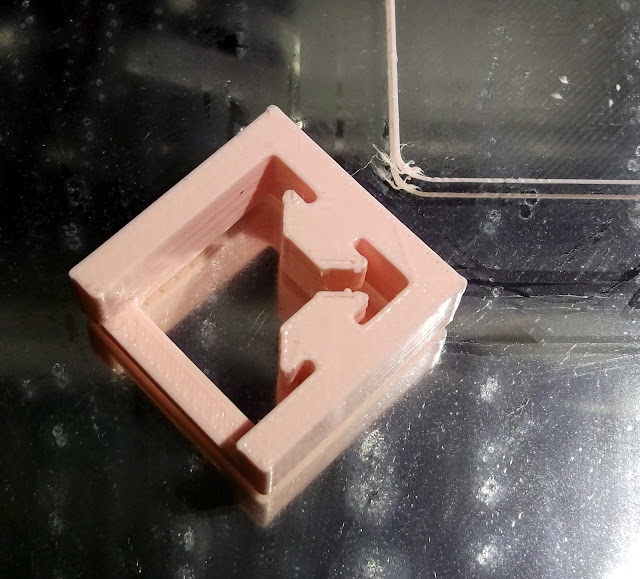

I Just quickly printed one on it's own, with my normal settings for RepRap parts - I think it came out perfectly, or at least exactly as I expected for PLA -
25% infill
1 perimeters (+extra when needed)
3 solid layers
0.3mm layers
Maybe you should also add a printing time element - this sample print was 9mins 21 seconds - it could be printed a lot faster.
0.2mm layer height would make it look a tiny bit nicer, but at longer print time, what's the most important factor after size?
It slides onto a KJN 20mm section tightly and can be moved up and down with some force applied (2 fingers+thumb), it feels like a very nice fit, so the.STL is very well dimensioned I would say.
The photos are about 15 minutes after printing, straight off the printer - (printed in Faberdashery Cherry blossom pink)
My dimensions read as 19.97, 19.98 and 1.51, (1.52 and 1.53 measured on the other gaps)
Mendelmax 1.5 (Slicer 0.9.1) - Jhead nozzle 0.5mm (3mm filament)
First layer speed is always 30%
; layer_height = 0.3
; perimeters = 1
; solid_layers = 3
; fill_density = 0.25
; perimeter_speed = 65
; infill_speed = 75
; travel_speed = 290
; scale = 1
; nozzle_diameter = 0.42
; filament_diameter = 2.86
; extrusion_multiplier = 1
; single wall width = 0.47mm
; first layer single wall width = 0.80mm

Wow, nice print ! Really good on the dimensions smiling smiley

Richrap, nice print, you put the bar quite high for a first submission. I haven't expected people already having a nearly perfect calibration. I should have expected it from you winking smiley
With or without the blobs at the corners? tongue sticking out smiley

Warts & all ! - I have never been all that interested in ultimate high quality, more reasonable accuracy and print time.
Buy it does fit quite well.

Overall a good improvement, especially in the gaps.
New readings are:
27.81 x 27.68 external
19.82 x 19.57 internal
1.49 x 1.51 and 1.50 x 1.48 gap
3.99 x 4.01 wall thickness
First attempt
Second attempt
Side by side - first on the left, second on the right

@richgain - No problem, glad it helped. That's looking really great!
Do you have the original cast X/Y pulleys on the Huxley? or metal ones?
Have you also printed it on the Mendel90 to compare?

@richrap - Yes, still using the original resin-cast pulleys on X and Y on the Huxley. What's your experience of them?
No, I'm planning to try on the Mendel90 some time today. Will update when it's ready.
For quality and tolerance, I've always found the Huxley more accurate, probably because of the finer nozzle and lightweight Bowden-fed printhead.
This should be an interesting test.
