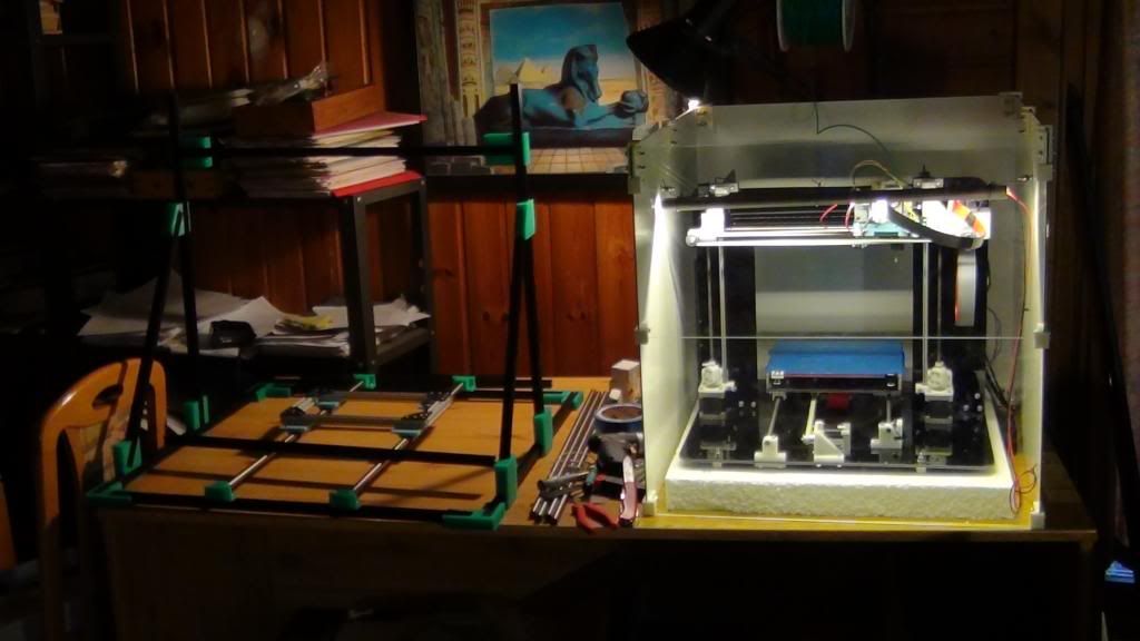

Dibond for the side and back plus acrylic panels to slide in: photo DSC00104_zps9607e332.jpg

@Ralph: Do you find the polystyrene base has helped reduce noise\vibration? I noticed a significant drop when using the printed 'feet' from Thingiverse, but your idea looks good also.

Tom - yes - it gives a major noise and vibration improvement.
