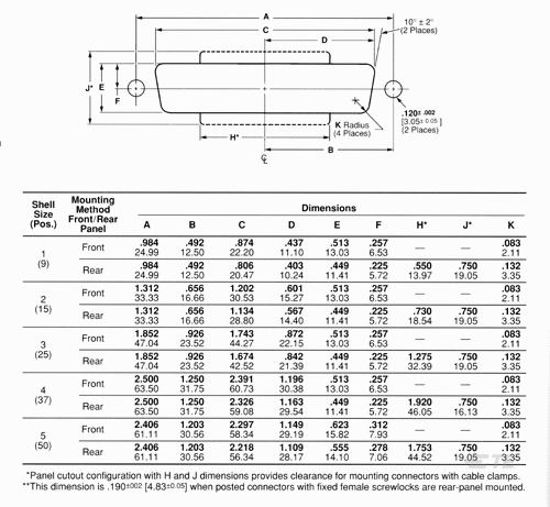

Does anyone know of a library to create d-sub connectors? I'm looking to make a panel to mount a db-15 connector and was wondering if someone has a library already done before I try to write create one myself.
thanks
david
Re: d-sub connector library?
October 29, 2015 10:27AM
There are some OpenSCAD libraries around but I couldn't locate one for rs232c (db-N) connectors.
OpenSCAD User Manual/Libraries
Libraries · openscad_openscad Wiki · GitHub
But then what do you really need?
You obviously want to make a cutout in a panel for a db-15 connector (a good starting place is HERE).
Using the above HERE link you can easily create a module to generate the needed form.
You could either use a RoundedBox with two cubes subtacted for the main portion and two cylinders for the holes or perhaps even easier a hull() { of four cylinders } plus two cylinders for the holes.
Using the table you could then generate your object to subtract from a panel for all defined types.

Well here is what I came up with:

Yes, exactly in the direction I meant!
b = db_conn_table(conn)[0];
d = db_conn_table(conn)[1];
f = db_conn_table(conn)[2];
k = db_conn_table(conn)[3];
shouldn't this be instead
b = conn_dimensions[0];
d = conn_dimensions[1];
f = conn_dimensions[2];
k = conn_dimensions[3];
Since you already used:
conn_dimensions = db_conn_table(conn);
Also I would translate the whole thing down h/2 so it is also centered vertically.
I might have made it 10mm high but the USER can always use scale([1,1,factor]) to get the desired height when using 1mm.
Nice job! Quick and easy but does the job very nicely.

I would make the following changes to be able to use properly it as a library:

Good work. Might be an idea to include an optional "oversize" parameter to make the D cut-out and mounting hole diameters larger (in case you need a looser fit and/or to compensate for the printer making the holes smaller).

One last change needed:

Using cos(10) is incorrect!
2(f-k) tan(10) is the correct distance!
As the height of connector increases so must the offset used in order to maintain a 10° angle.

And HERE a version with dmould's suggestion implemented (an optional gap):

COS is often mistakenly used instead of TAN (and vice-versa), because their values are almost the same for small angles (because the hypotenuse is almost the same length as the adjacent side), so the mistake is often not obvious on the model.
Dave
November 04, 2015 04:27PM
No, it is the sin(x) that is very close to tan(x) where x is a small angle but he didn't multiply by the hypotenuse, he just used cos(x) which is a factor (adj/hyp) and not a length! Dividing mm by mm is unit less.

I still need to change the diameter of the lower cylinders. If you look at the specifications k is the radius of the bottom curves but it was used as the diameter. Would have done it already but I currently don't have a working computer at home.
