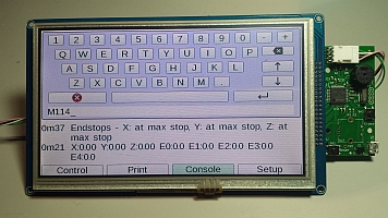

Now that I have added full support for the 5 inch display to PanelDue, I thought it was time to look at alternative 5 inch displays.
The one I tested with is the ITBD02-5.0 here [imall.iteadstudio.com]. The price is $44 + $6.43 shipping, + any import VAT you get stung for. Shipping to the UK takes about a week.
There is another 5 inch display here [www.ebay.co.uk] and here [www.ebay.co.uk]. The price is about GBP21.50 including shipping, plus import VAT if you get charged it (sadly, the basic price of the display is a little over the UK import VAT threshold). These are the same suppliers (possibly both the same supplier?) that provide the alternative 4.3 inch display that works with PanelDue. I expect this one to work too. Like the alternative 4.3 inch displays, the connector is on the side instead of at the bottom. The only uncertainty I have about it is that if it takes much more than 300mA from the 3.3V supply to power the backlight, then the 3.3V regulator on the PanelDue may get rather hot. The Itead display runs from 5V, so this does not apply.
I have around 20 PanelDue boards left. I understand that Think3DPrint3D have a few complete kits including 4.3 inch display left too.
Here are some pics taken with the 5 inch display. I would be grateful for suggestions on how to improve the layouts and/or make more use of the graphical capability of the display.
