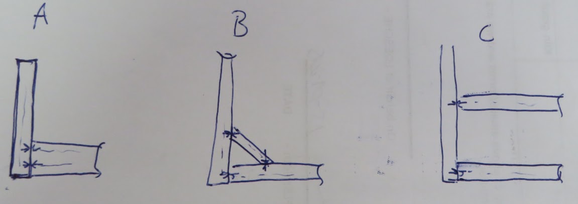

The second thing, about your current structure with the 2020 and 2040.
For the lower rectangle I think you have it very well supported now. For connecting the vertical to the horizontal 2040 you can use plates like these:
You can also print something like that but with angles implemented. I am not so sure you need the 45 deg bracing if you do that, but it sure wont hurt and you can always remove (or implement) it later.
do you think if i used these in all those corners it will fix the issue. i would love to add 45deg bracing but they will get in the way of the linear carriage.Quote
LarsK
What I am concerned about is the upper rectangle. In particular what I am trying to sketch here:
I know in this sketch I have sketched it as a angle but in fact in your current revision you are using a steel plate - The thing is, the steel plate is even worse. Single bolts cannot take up moments of rotation. It will work like a hinge.
In general you really need to get more stiffness downwards from the upper rectangle . You need some kind of bigger plate. That plate needs to be really firmly bolted on to that 2040 horizontal and then go and connects with at least two bolts on the 2020 vertical. Or you need 45deg bracing like you did on the lower part.
