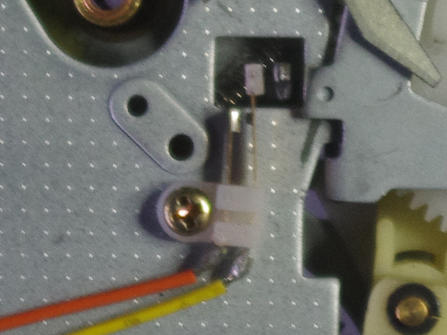

MKSA
And the simplest, accurate, no messing around, light, immune to normal t° change, magnetic field ... is to have a leaf switch NC. Same principle as probe used on machine tools.
As they are quite expensive, I made one using berylium copper gold plated Berg connectors. Just for my Z axis indeed..
.That would fall under the NO category though...|

MKSA
As for a removable probe, the best, would be try to make one. It is a good occasion to learn what a micron really is, how to design, make accurate mechanical parts, etc.... Of course, the conclusion would be, not useful here but the skills gained are worth it.
