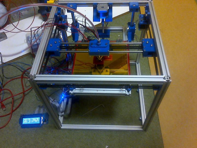

LarsK
One thing nobody has talked about - Does the belt go above the rods or in between (behind) the rods.
This is my new design on one of my printers:
SO here you see the belt goes behind the smooth rod. It could also go above and under but that would take up more space and induce a bigger vertical twist
Re: Rugged CoreXY June 07, 2016 06:33AM |
Registered: 9 years ago Posts: 168 |
lkcl
LarsK
very nice arrangement. like the belts being the inner side of the rods. offset above and below... all belts come in on centre... yes i do the thing where the belts go behind the moving x-rods as well, that made sense to me, keep them as close to a centre-line (vertically) as possible.
what you've done here LarsK is i think about the closest it's possible to get to being balanced under acceleration and reduce acceleration-induced bearing side-wall loading.
putting the belts inboard from the y-rods also means the y-rod bearings are not torqued (side-loaded) as well, which is great.
thought about what you, jamesk and hobbymods i think mentioned yesterday, with stacked (height-offset) belts the difference in height could produce torquing of the carriage about the.... *thinks*... Y-axis under heavy acceleration. so keeping them as close together but also an equal distance above and below the line of the x rods would be good, and i think that's what you did in that new design, LarsK.
only one other consideration - keeping the centre of gravity of the carriage as close to the rods as possible *and* keeping the hotend as far up as is possible... two rather diametrically-opposed things unfortunately oh well
